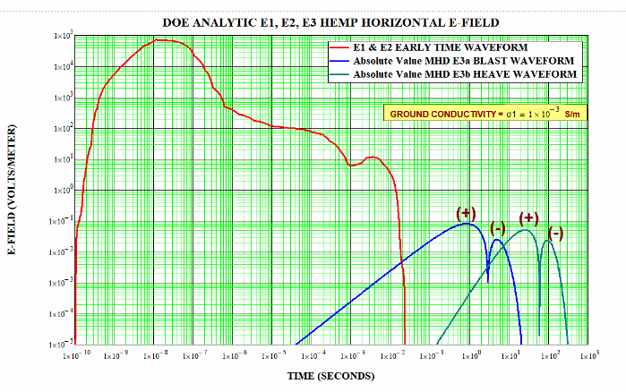

I have two different Cases construction for the E-field. Neither is correct. I have shown images of the MATHCAD construction. If you enable the orange Cases calculation, the answer is correct for E1,E2 and E3a, but not E3b. If you disable the orange calculation, you only get the correct answer for E1 and E2. The late time E3a and E3b make no sense.
HEMP E1 PLUS E2 PLUS E3a PLUS E3b.sm (149.7 KiB) downloaded 1862 time(s).
It works as expected in MATHCAD as shown in this graph. Also, MATHCAD allows for the maximum time = 1000 seconds or more. The maximum time in SMATH is limited to 100 because in the cases construction it apparently calculates all formulas for the entire time range, independent of the ranges defined inside the cases construction. This seems to be a bug to me.

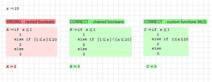

#6 Posted: 2/26/2025 4:57:41 PM
Hi reg,
Yes
Here you go:
![2025-02-26 09_52_32-SMath Solver - [booleans.sm].png](/en-US/files/Download/3VcZhC/2025-02-26-09_52_32-SMath-Solver---[booleans.sm].png)
booleans.sm (6.29 KiB) downloaded 1864 time(s).
It is a common mistake. Thet's why we have parenthesis surrounding booleans, the program itself doesn't require them, but users initially miss the underlying logic.

WroteDavide,
Could you kindly show me how with an example?
Here you go:
