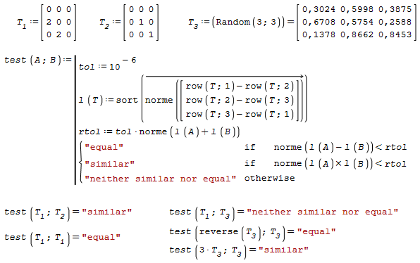

Here's a good task (test) for the SMath fans.
The coordinates of the vertices of two triangles are given.
The program returns three text messages:
1. Triangles are equal
2. Triangles are similar
3. Triangles are neither equal nor similar

Nice exercise!
ttest_Kr.sm (9.34 KiB) downloaded 1480 time(s).

Nice exercise!
