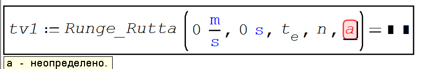

Why I have an error in second sheet?
Rocket-s-Euler-RK.sm (89.49 KiB) downloaded 1419 time(s).
Rocket-s-Euler.sm (28.67 KiB) downloaded 1411 time(s).

Runge_Kutta not Runge_Rutta
Also extract t1 and v1 from tv1.
Rocket-s-Euler_b.sm (34.4 KiB) downloaded 1468 time(s).

But see please the error message
It's an extremely misleading error message!
