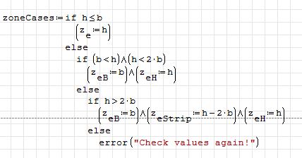

any way i can print a message in a for loop?
i have 3 cases that change 2 variables, but it would be useful to know in which case i'm in
thanks in advance
#6 Posted: 3/14/2013 10:08:17 AM
1,443 likes in 2,936 posts.
Something like this?
regards,
w3b5urf3r
zoneCases.sm (8.59 KiB) downloaded 1538 time(s).
#7 Posted: 3/18/2013 8:31:18 AM
dan
dan
0 likes in 4 posts.
yes that did it,
thank you
