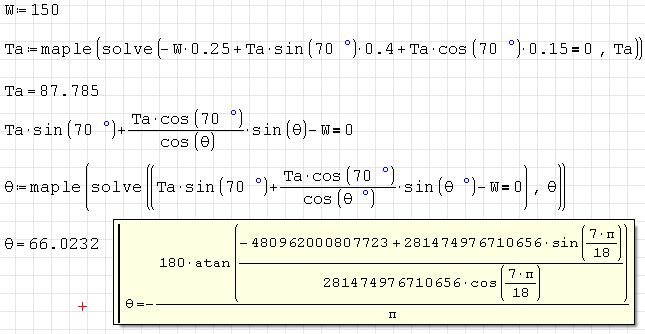

I found this behavior working with Maple plugin:
arctan() function not defined
I think that it would be easily fixed by uni
Thanks in advance!
Oscar

I think that you can use directly:
ExpressionString = ( new Regex( @"\batan\(" ) ).Replace( ExpressionString, Functions.Arctg + @"(" );
ExpressionString = ( new Regex( @"\barctg\(" ) ).Replace( ExpressionString, Functions.Arctg + @"(" );
using the Functions.* you don't need to write the right SMath function name.
best regards,
w3b5urf3r

Oscar, could you attach the file and the log (mvr5.txt)? As for me your example works fine.
@w3b5urf3r
Thanks, I forgot about that.
Here the files.
Thanks in advance!
Oscar

Fixed and updated. Try now.
