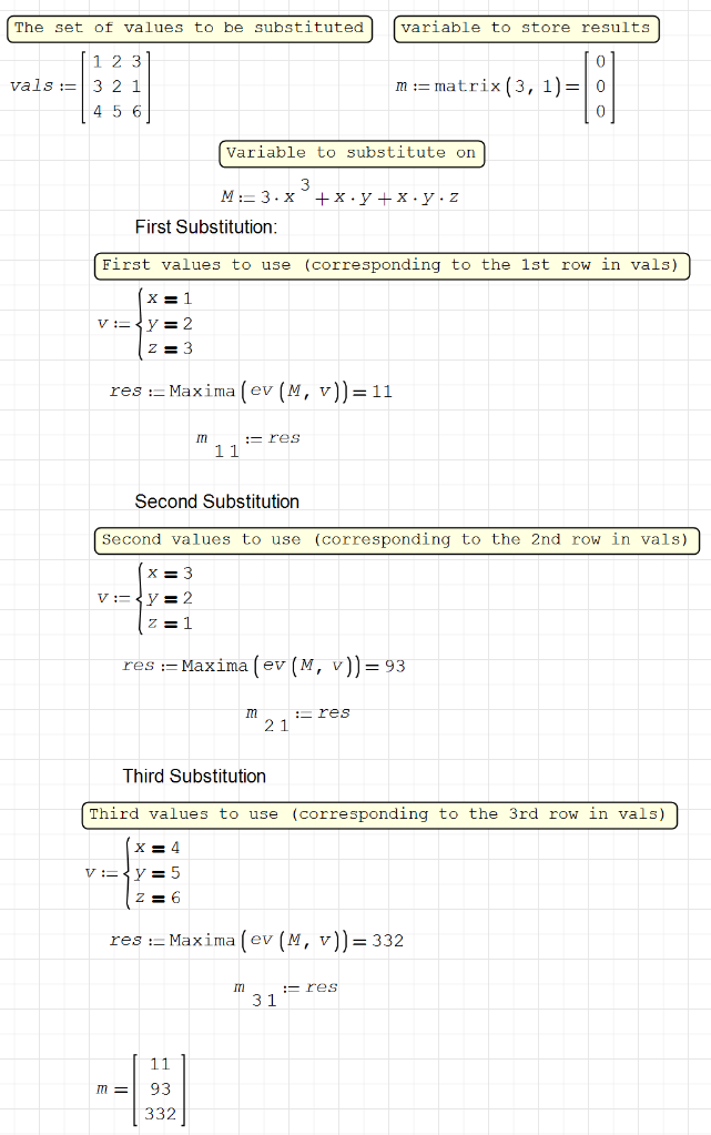

Dear all:
I am new to Smath Studio, great software!
Even I am new to its usage, I am trying quite complicated calculations I guess.

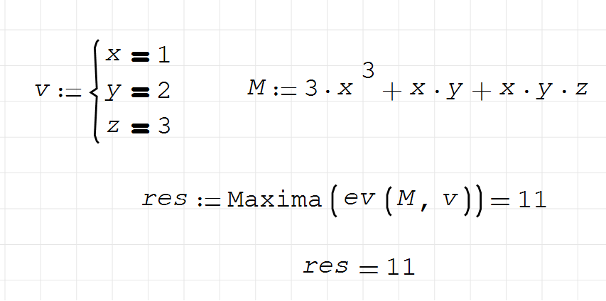

I am putting the following lines:
As you can see, I am using Maxima plugin and the Maxima function ev() to substitute values in the symbolic variable. I have some specific questions:
1.) Is there an alternative way to do this kind of calculations without using the Maxima plugin?
2.) v is a system of values, each value is an equality, is there an automatic way to generate a system of values?
Thank to all the people that could help.

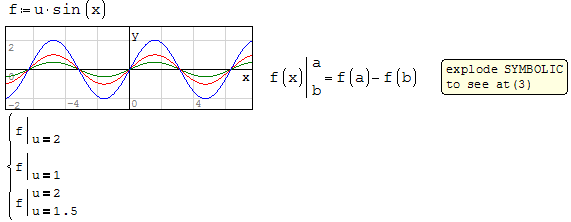

#2 Posted: 4/12/2022 5:04:06 PM
1,361 likes in 2,275 posts.
I can't open your image. From what you describe, you might want to use the substitution function at() from Custom Functions plugin.
at.sm (22.23 KiB) downloaded 1283 time(s).

#4 Posted: 4/12/2022 6:51:35 PM
#5 Posted: 4/12/2022 7:41:47 PM
Mario Acevedo
Mario Acevedo
0 likes in 11 posts.
Sorry about the image, now the image is visible.

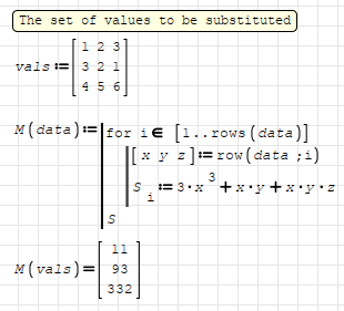

What I want is to iterate over a set o values to substitute in a variable a store the results in a variable, something like this:
Is there a way to do this substitutions in an iterative way?.
I mean: using a set of programming lines?
In this worksheet I copied and pasted the lines to perform the iterations, but in a general problem solving it is desirable to iterate automatically.

#7 Posted: 4/12/2022 8:45:20 PM
Mario Acevedo
Mario Acevedo
Thank you Martin Kraska, at works fine and is what I needed.
It seems that to iterate I have to declare the sys vector by myself, isn't it?
Thanks a lot!

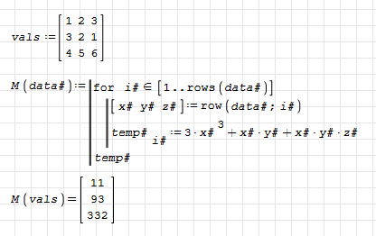

#8 Posted: 4/12/2022 9:29:50 PM

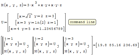

An iterative process is a solving process.
As you say, you just want to plug something from command line.

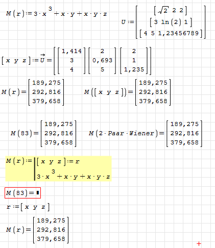

I take inspiration from Jean, but I use the Vectorize function and I forget the size of U

Pay attention! The definition of M(r) doesn't make much sense.

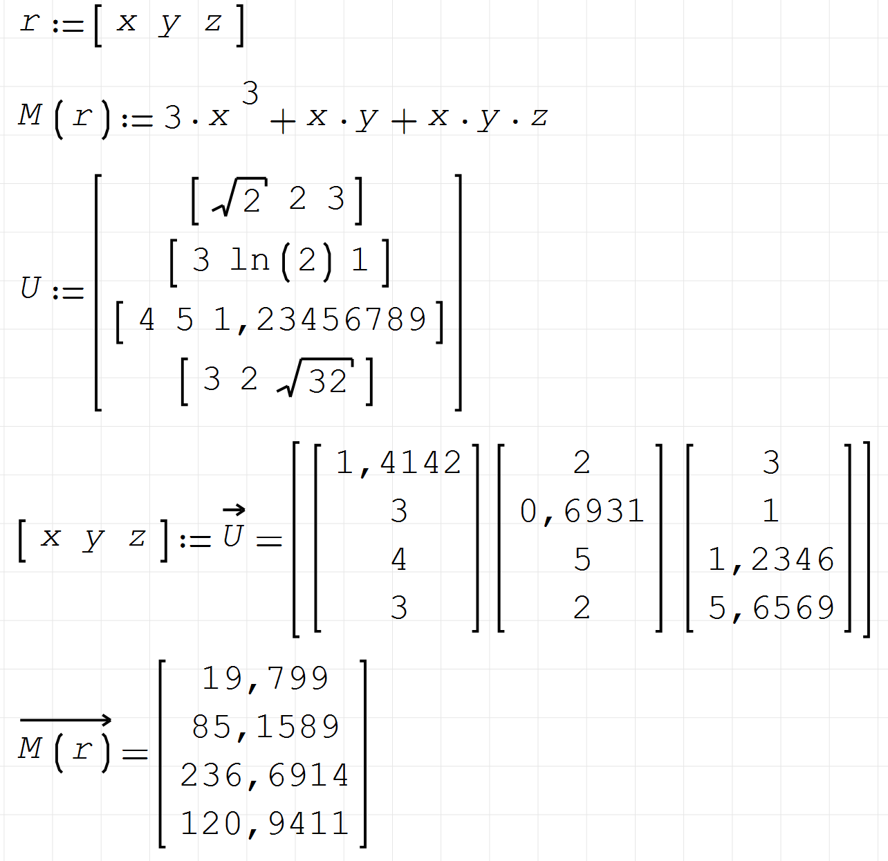

Superb Sergio ... added in the main document.
#13 Posted: 4/13/2022 9:48:44 AM
600 likes in 1,381 posts.
An algorithm can also be used.
It may be simpler by this way.
Worksheet1_algorithm.sm (4.69 KiB) downloaded 1279 time(s).

Just a question, does the S variable had to be declared and dimensioned previous to its use?

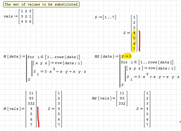

You should always define variables used as arrays in function before assigning elements.

#16 Posted: 4/13/2022 4:04:10 PM
Just a question, does the S variable had to be declared and dimensioned previous to its use ?
No, it sets by itself within the for loop.
Wise to clear within the algo ... U:=0
That will avoid interaction with else U above document.
Algo style is an immense companion in Smath.
Personally, I use it as much as possible,
it enables the local command line.
Cheers ... Jean.
