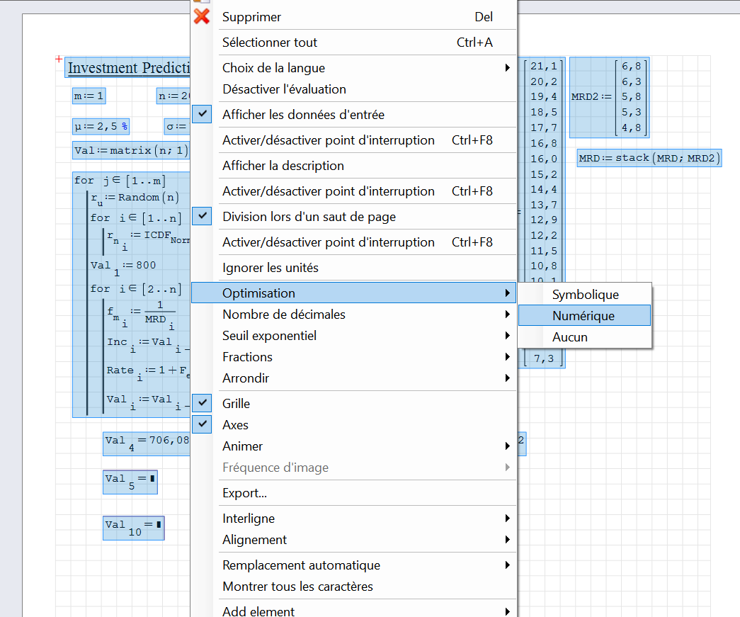

Try to put "numerical optimisation" over your formulas.
Ioan

4. As about “optimization mode”, you cans specify your option for the whole program, by selecting (Ctrl+ A) all the content and then right click the mouse and precise yous option, as here:
Hope being helpfully,
Ioan
