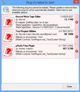

Hello
The following plugins crash in Smath Studio 0.99.7679
Carlos
sergio 1/9/2021 6:08:00 AM

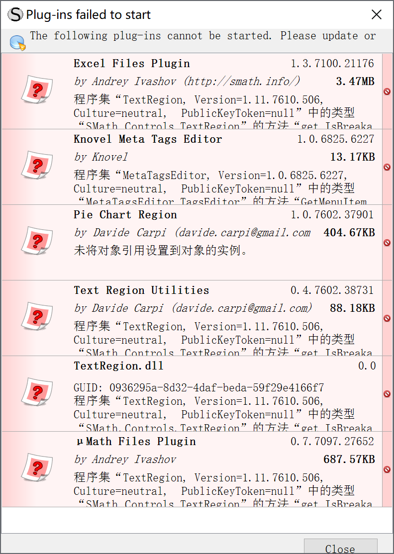

I have the similar issue:

Is it possible to add a button to temperally disable plugins so they don't get loaded at startup but still can be checked for update?
#5 Posted: 1/9/2021 12:42:03 PM
2,343 likes in 4,044 posts.
I will update these plug-ins soon.
Currently it is not possible.

But the Text Region Utilities plugin keeps crashing
Carlos

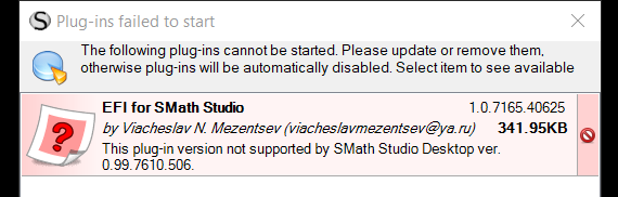

UNI's EFI plugin is crashing too.
My new portable install has no plugins at the moment
Should I remove it per 0.99.7610 is available
#13 Posted: 1/13/2021 10:01:00 PM
Strange. Just checked EFI plug-in - it loaded correctly in my SMath Studio installation.
As you see from the screenshot above, I'm using version 7610 (portable version). I uninstalled the plugin and reinstalled. The install went well and no errors. However, once I restart SMath, the error pops back up.
Could it be a portable version issue?
