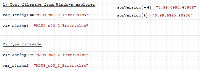

I was having problems importing an excel file, thought it was a problem with the extension, but some sheets continued to work. The problem was due to the name of the file used as argument to the plugin.
The only difference between the strings shown below, is that in the first case the name was copied from a windows explorer window and pasted between ""(lazy me
), and the other was typed directly.
Both look the same, but SMath stores them differently, and when passed as an argument to the plugin, it fails.
Var_String1:
Var String2:
Error ST.sm (4.35 KiB) downloaded 1341 time(s).
Var_String1:
<math>
<input>
<e type="operand">var_string1</e>
</input>
<result action="numeric">
<e type="operand" style="string">M2U4\005F\m03\005F\2\005F\Error\002E\xlsx</e>
</result>
</math>
Var String2:
<math>
<input>
<e type="operand">var_string2</e>
<e type="operand" style="string">M2U4_m03_2_Error.xlsx</e>
<e type="operator" args="2">:</e>
</input>
</math>

XlsxImportExport plugin updated; please let me know if it works properly so I'll update similar plugins.
#3 Posted: 2/26/2019 4:57:51 PM
Thanks Davide, i was using the Excel I/O plugin (EXCEL (2003+) I/O with recalculation and PNG export - 1.99.6849.42653), but the problem also applies to XlsxImportExport plugin.
The updated XlsxImportExport plugin (1.3.6996.39330) work properly with the same problematic strings (space, underscore, dot, etc). So i will switch to this one.

Wrotei was using the Excel I/O plugin (EXCEL (2003 ) I/O with recalculation and PNG export
Updated.
