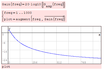

In Electronics Engineering that I am practicing since 1976, Bode Plots are essential. Zedgraph is the only way I found where you can set up the frequency scale logarithmically so that it would present a Bode Plot correctly in Smath Studio.
Based on you checking out the atan2 function and the bad result in Zedgraph I am venturing to say that the issue might be within the Zedgraph plotting engine and not in the Smath Studio software.
So this post of mine should go to someone who is either willing to jump into Zedgraph or create a similarly functioning plotting tool for Smath Studio. I am afraid to say that the standard Smath Studio plotting tool is a bear. It is very difficult to work with not being able to set it up as you wish and it completely lacks the logarithmic scaling functionality that an Electrical/Electronics Engineer would need as presented in my example.

WroteSo this post of mine should go to someone who is either willing to jump into Zedgraph or create a similarly functioning plotting tool for Smath Studio. I am afraid to say that the standard Smath Studio plotting tool is a bear. It is very difficult to work with not being able to set it up as you wish and it completely lacks the logarithmic scaling functionality that an Electrical/Electronics Engineer would need as presented in my example.
In lot of instances Mathcad 2D plots is more immediate.
Many of my 2D Smath are far superior for publishing.
log-log Bode plots is even more attractive than Mathcad.

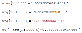

WroteI understand. Also last night after I got off teleworking I investigated the issue a bit further. I was wrong, the issue is not Zedgraph, it is how Smath Studio interprets atan2. I compared that with Matlab and Wolfram and both interpret it the same way as Smath Studio. Mathcad is the outlier here by following the Electronics Engineering definition of complex arctangents. Too bad but I believe this difference can be overcome with writing a programming function in Smath Studio to do that. I am not the best with these programming structures, my mind works a little different but hopefully will be able to do that on my own. It might take some time, but that is OK.

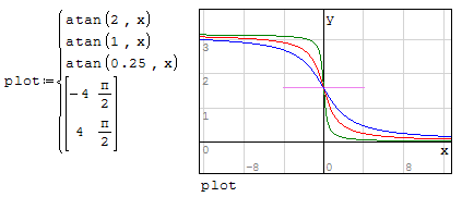

Oh ! my friend: calm down coding Smath/Mathcad
atan(2) was controversed in Mathcad up to 11.
In fact, Smath that is more largely based on universal libraries
often detects wrong MCD code, though not wrong within itself.
example: UnitVector(x):= x/|x|... nonsense as such coded Smath
Smath... UnitVector(x):x/norme(x) ... universal compliance.
