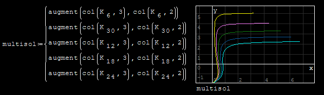

#11 Posted: 8/16/2016 12:31:23 AM
... like this:
#12 Posted: 8/16/2016 1:11:51 AM

Merci Jean! I will need some time to explore your explanations. My level in maths does not allow me to understand the difference between Dragilev and Runge-Kutta! And I like to use the latest version, since someone has worked on it! (Not always true, sometimes the newest version is a deliberate, clever sabotage of the previous one, but at least it's true for such a honest piece of software like Smath!)
