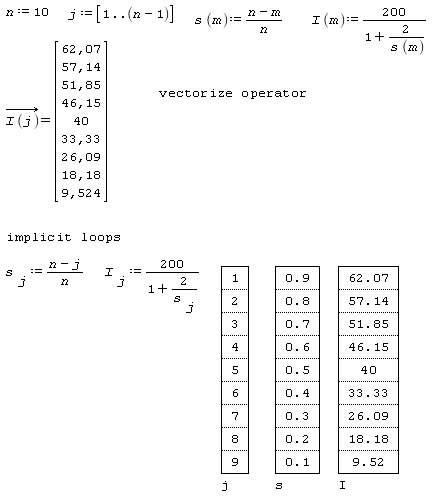

you divide by a vector. If you want to apply that by element, then use the vectorize operator.
Alternatively, you can use implicit loops.
In any case make sure that you don't divide by zero.

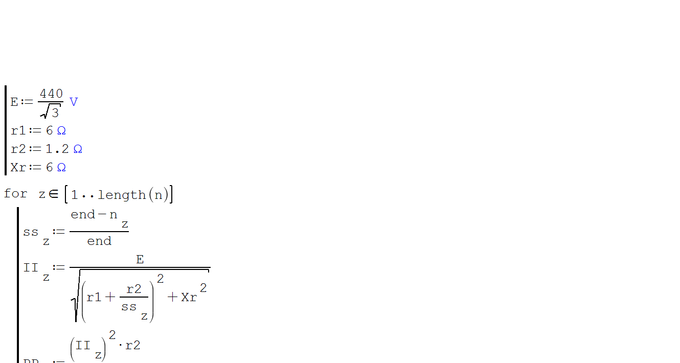

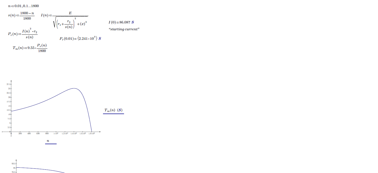

Too many parameters are missing to reproduce
r1, r2, E, x [u in Smath ... back to x in plot]

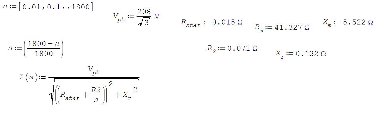

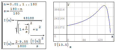

Thank you for your efforts, that's what I am looking for. I am resending the data with all the information. I have a few questions on your previous post, there is an arrow above 2/s and I(u)^2.What is that function. Also, you have used the value of u = 13.5? Also, when you plot the graph, did you just type T(13.5) to get the graph?
#10 Posted: 3/16/2018 12:18:34 AM
I am re-sending the data with all the information.
1. The arrow is the vectorising operator [same as Mathcad].
2. 'u' is the wild parameter of same nature as r1,r2
3. The system runs over 'n' taken into account wrt the vectorised arguments.
4. Shift@ to get the plot region, type T(13.5) then [ to get the index operator
then type x. The Smath plot argument is 'x'. So, by indexing, it will plot over
the running 'x'. If you want to plot ln(x), just type ln(x) in the plot place holder.
I will try to code your latest information, but busy next three days.

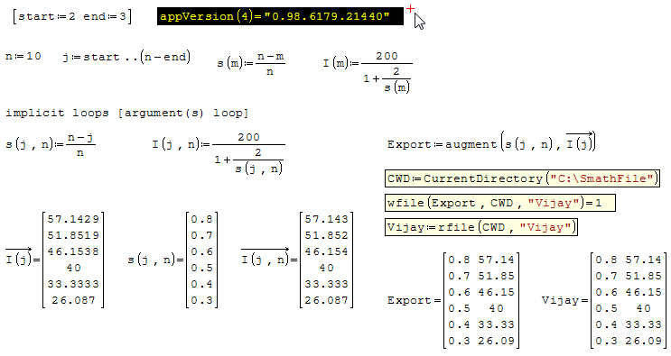

Back to original.
Vijay(1).sm (7.11 KiB) downloaded 1181 time(s).

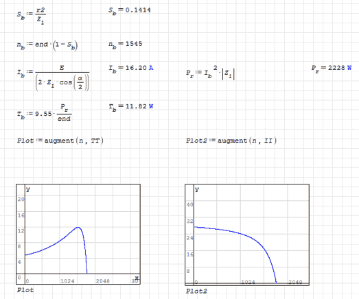

Attached is another similar file for which I have included the circuit diagram. I am assuming this will be posted in samples in this foroum.File not found.File not found.

#19 Posted: 3/16/2018 8:55:29 PM
May I suggest you post this as an example
Visit => Samples => Motor Analysis [20180316, 19:52]
Drawing was sharpened to the possible limit,
if you have a better one, please offer.
