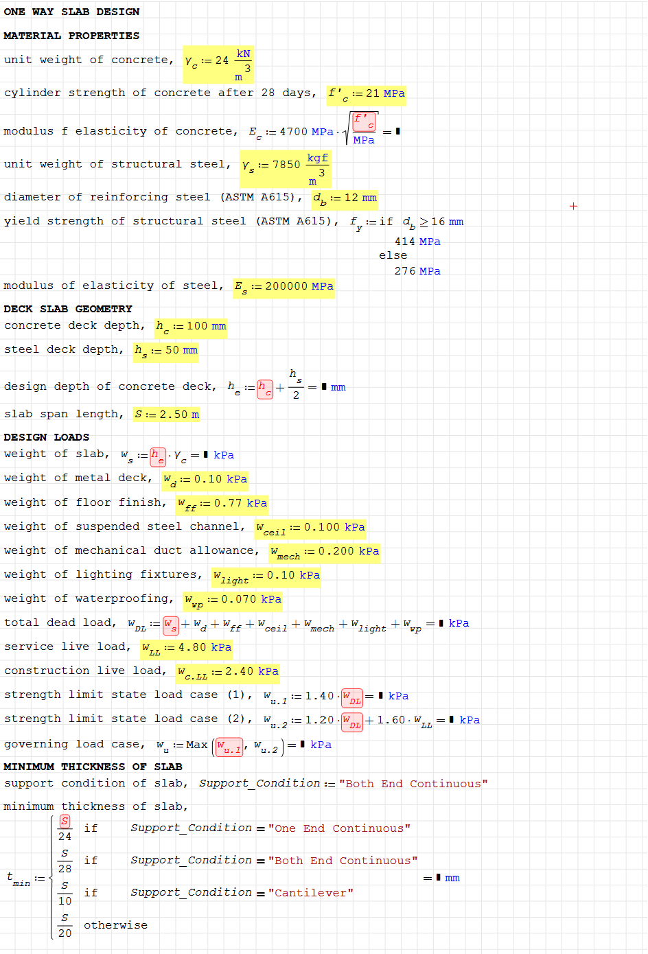

(1) Where does that cream-colored rounded rectangles come from? Is that a text region, a special function? I tried to replicate that days ago but I went blank how to.
(2) May you look at the image below. I generally use: [text goes here, variable:=1mm] all in the same line and it comes blank. This was not available in Mathcad and was actually a good thing for me since I possibly can't misplace their descriptors whenever I'm moving things,especially variable, around. Problem is this one makes an error for me. Is what I'm doing a bad practice?

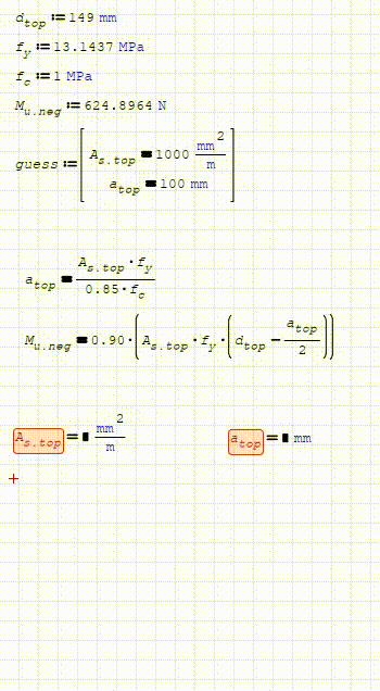

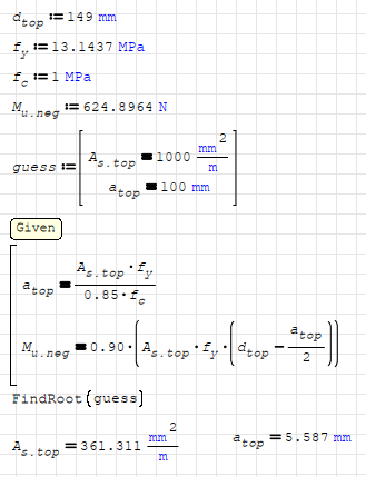

WroteIs there any way that this could be replicated ? I've been using solved symbolically and FindRoot but if there is another intuitive go around would be appreciated.
Yellow marked were initial values for finding the roots.
Commonly, plugins solvers fail. in lieu, you rescue via:
1. root Dichotomy for single/multiple roots.
2. solve Xsecant for single/multiple intersections.
As you wish, attach your original document for inspection
Wrote(1) Where does that cream-colored rounded rectangles come from?
Those are description text.
Right click to math/plot/table rehion and you will see an option from that menu.
Wrote(2) Is what I'm doing a bad practice?
İt is all up to you.
Don't think it as bad or good.
There are sheets you activate description and it is enough.
And there are some you put text region.
İt depends on visual aestethics of that particular sheet.
By the way, SMath is similar but not same to Mathcad.
Don't expect 100% conversion. But you can do everything on SMath as done on Mathcad. One way or another.
