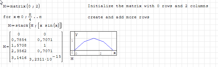

#8 Posted: 2/3/2017 9:29:55 PM
1,359 likes in 2,273 posts.
Example for declaration and use of an empty matrix:
stack.sm (11.99 KiB) downloaded 1502 time(s).
Arie 2/3/2017 10:03:00 PM
#9 Posted: 2/3/2017 10:03:19 PM
Arie
Arie
94 likes in 285 posts.
Awesome. Thanks, Martin. I did not know that empty matrices were supported.

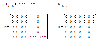

#11 Posted: 2/4/2017 10:32:43 AM
... technical matrix
