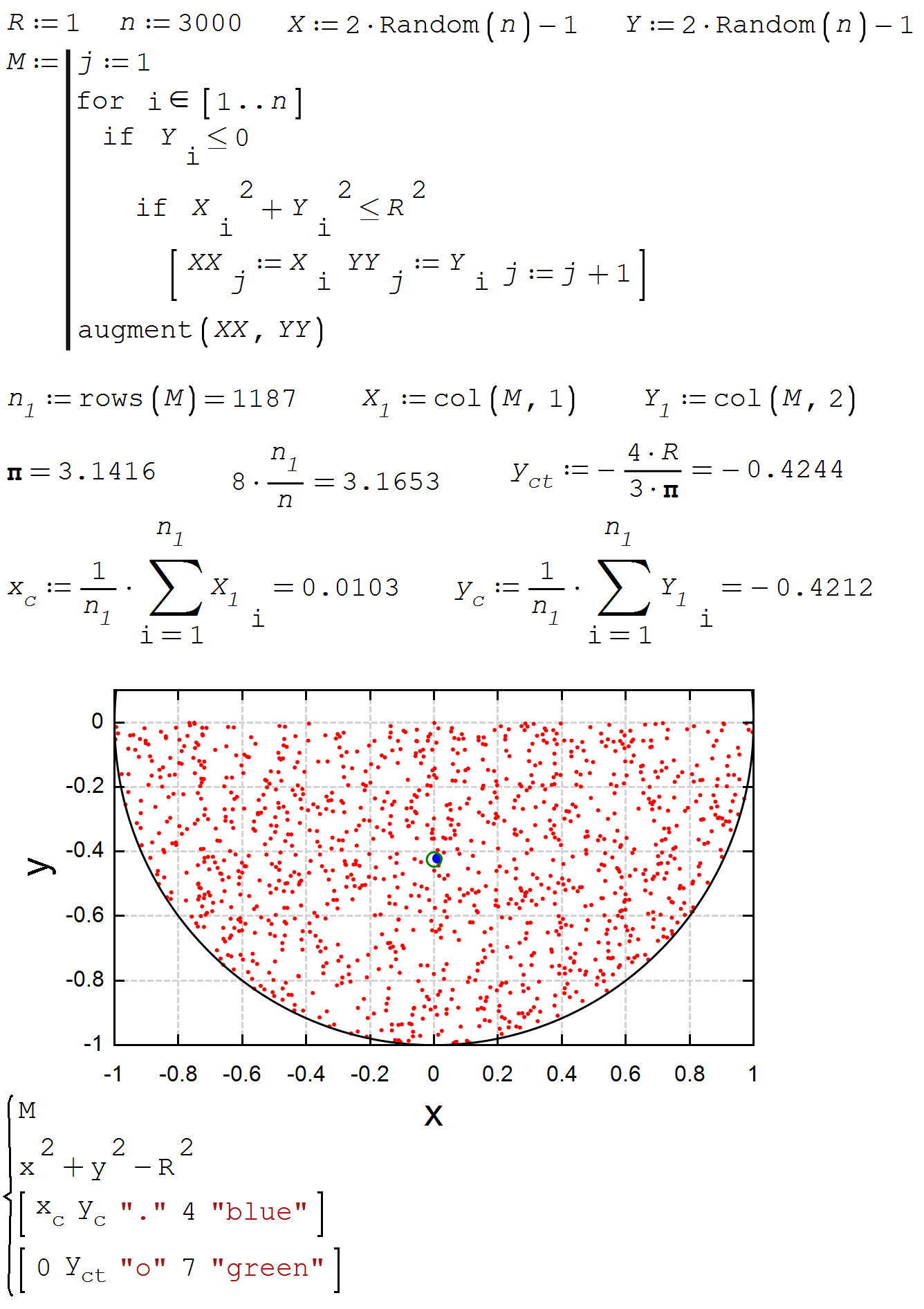

Help me please - see attach
Gravity-Center-n-points.sm (331.61 KiB) downloaded 1540 time(s).

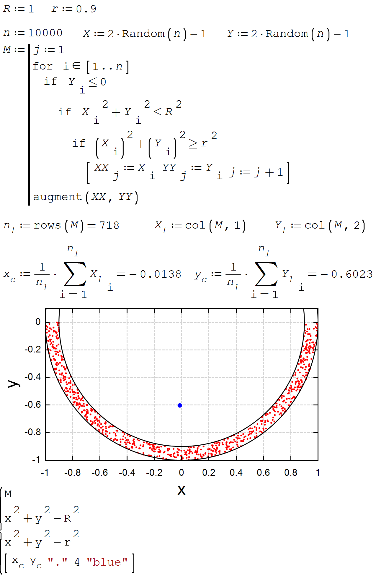

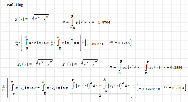

Solutions for same mass of points. OK?
Gravity-Center.sm (14 KiB) downloaded 1602 time(s).
One test

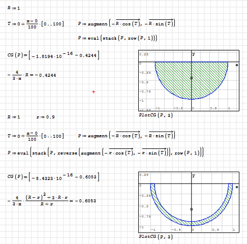

For comparison, the true value for your semi-annulus is given by 4*Reff/(3pi),
where Reff = ( (R-r)^2 + 3R*r )/(R+r).
With R=1 and r = 0.9 this is 0.60534722.

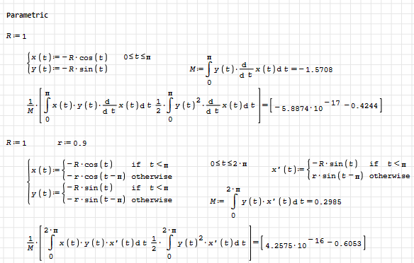

Hi. Using Martin's Momentums functions for polygons.
mass-center.sm (38.17 KiB) downloaded 1782 time(s).
or (adenda)
mass-center more.sm (21.61 KiB) downloaded 1670 time(s).

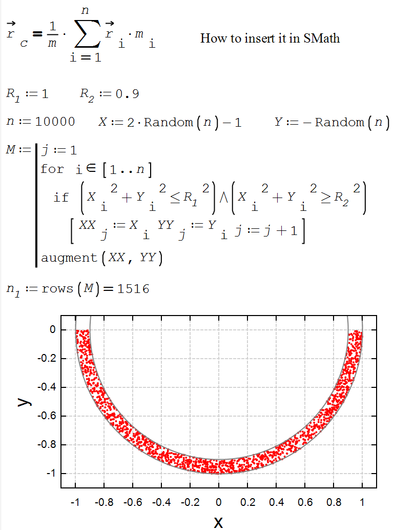

See please pictures in my old article
Physics and computer science: the center of gravity of a black box
http://twt.mpei.ac.ru/ochkov/Center-Gravity.pdf

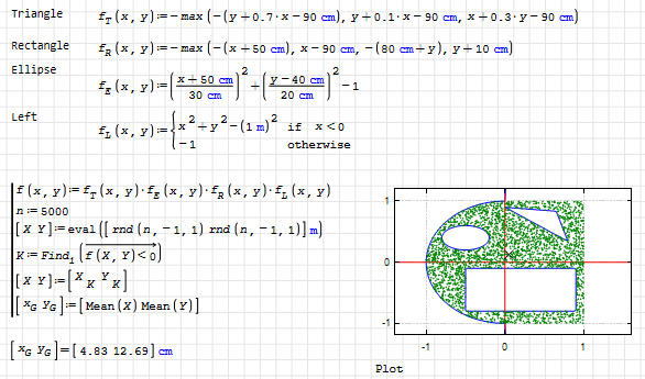

Oh, I see. The intention is to use statistical functions. This vectorized version can replicate more or less the results, but SMath is very slow for large vectors.
mass-center-statics.sm (52.11 KiB) downloaded 1574 time(s).
mass-center-statics.pdf (307.24 KiB) downloaded 904 time(s).
