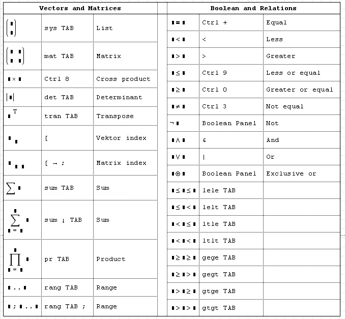

The snippet contains tables of operators and functions with special formatting and their corresponding keyboard input.
This might be of help until these functions all made it into the side panel (feature request SS-202)
There are some problems with the formatting of expressions in the tables, see SS-201
Usage:
- type "help" and press TAB - the tables are inserted in an area region
- expand the area region and inspect the tables
- if you are done, just collapse the region and delete it.
