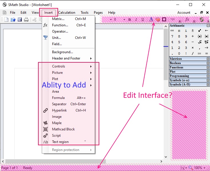

I am curious: outside of being able to add controls to the 「Insert」 Menu (via IPluginCustomRegion.GetMenuItems); can a plugin add custom Toolbars or interface with the Status/Title Bars?
I am familiar with the ability to add a context menu item (via IPluginCustomRegion.GetContextMenuItems), as well as the ability to create/launch a customized Windows Form (e.g., InputBox, Msgbox, etc.); I am more or less focusing this question with regards to those areas as indicated in my image.

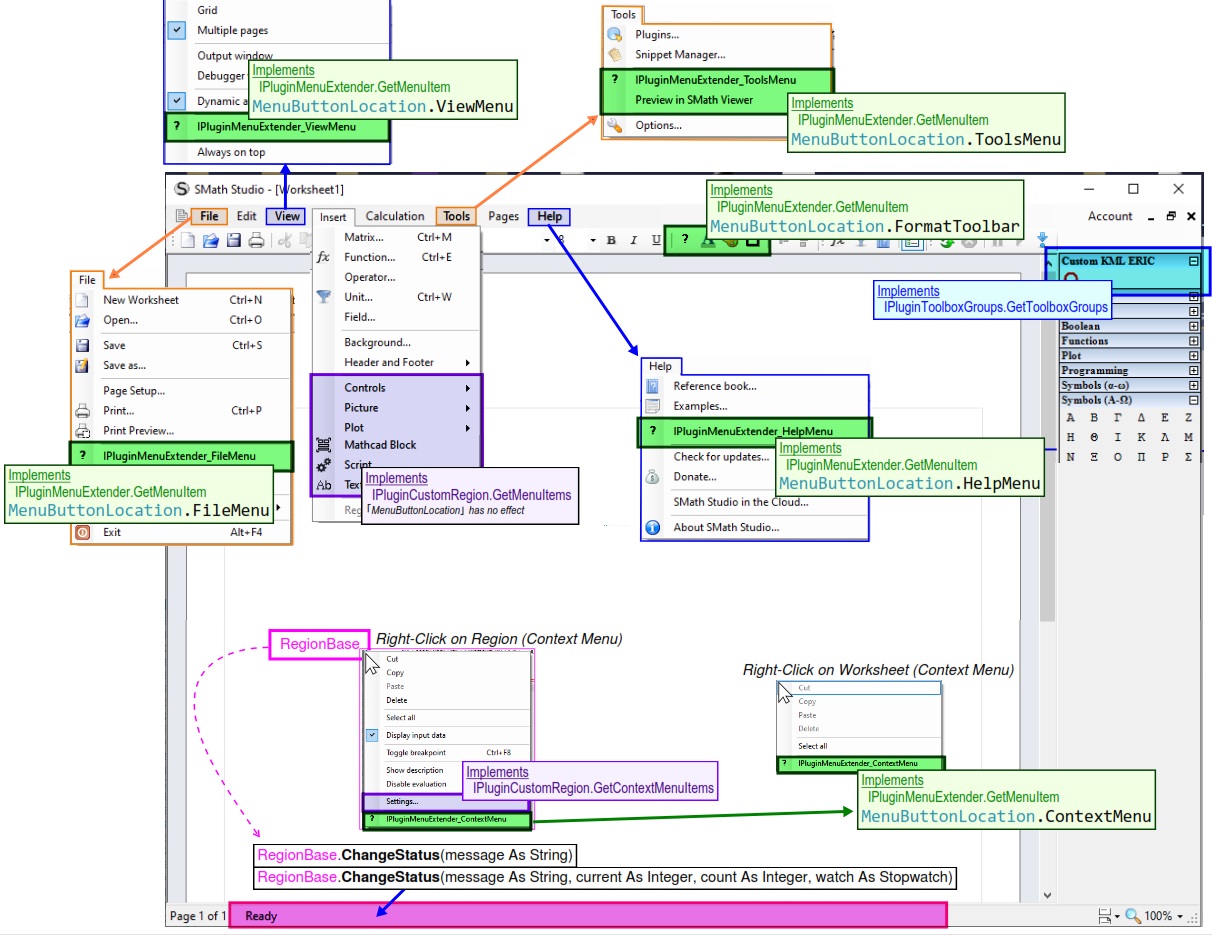

Since I am a visual person, I took the liberty to highlight the areas a Plugin is allowed to mount within the GUI (per Windows Application); Please let me know if I overlooked an area/feature:
