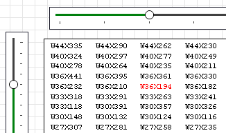

Just for fun: here is table selector based on sliders with selection highlighting by a 2d plot region. No use except being a small programming exercise...
Note: by changing the position of any region, the z-ordering if plot region and matrix seems to be reversed.

I don't know why, when the focus is on a slider the plot zone turns invisible and vice versa, being hard to use.
Very strange. As shown in the attachment, the matrix keeps being displayed in front of the plot region when the slider has focus. If I shift any region by just one step, then the plot region comes to the foreground and the matrix disappears. But you obviously mentioned a different problem, which I cannot reproduce.

By putting focus on the slider (as you can see) the plot zone becomes white.
I tried this on two different computers.
The same for me, but you can see the figure shown by Martin if you select both the matrix and the underlying image region and you move a little bit to the bottom the selection.

This one is more robust, no overlapping regions and no quotes any more. Much easier to adjust.
