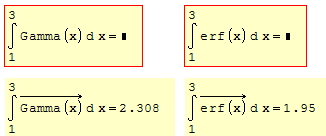

Different Results of Integration in 7219 & 7250 (Gamma Function)
Different Results of Integration in 7219 & 7250 (Gamma Function) - Messages

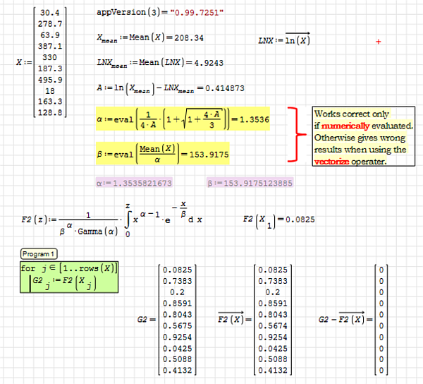

#25 Posted: 11/14/2019 6:01:53 PM
NDTM Amarasekera
NDTM Amarasekera
130 likes in 352 posts.
Observed same problems even after a second Clean re-installation of 7251.

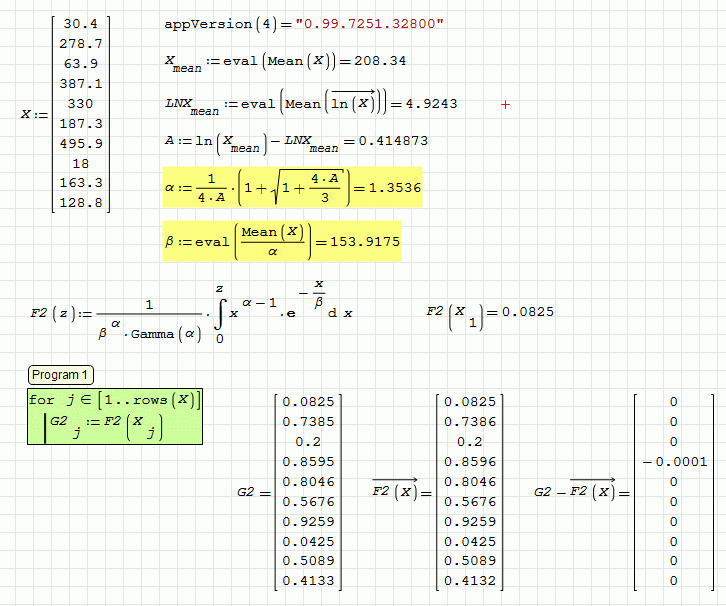

Consequently, I noticed that the Vectorize operator works correctly
when eval() function is used to evaluate alpha and beta of the Gamma function.
Otherwise, it gives incompatible results.
Has anybody experienced this issue?
Thank you Jean for the inspiration and encouragement.
Thank you Alvaro.
Any comments?
New_Test_Gamma.sm (14.46 KiB) downloaded 1398 time(s).
#26 Posted: 11/14/2019 7:23:02 PM
1,138 likes in 1,805 posts.
Any comments?
New_Test_Gamma.sm (11.13 KiB) downloaded 1413 time(s).
Hi Nugegodage. I slightly modify your file, putting eval only where Mean appear. What I see rigth now, with your new file using eval, not before, is that there are not bug, and the "bad results" are because Mean can't be vectorized (or better say, isn't a good idea vectorize them), like any other function that take vectors or matrices as arguments.
#27 Posted: 11/14/2019 9:08:16 PM
Not clear what's incompatible in the yellow/red brace.

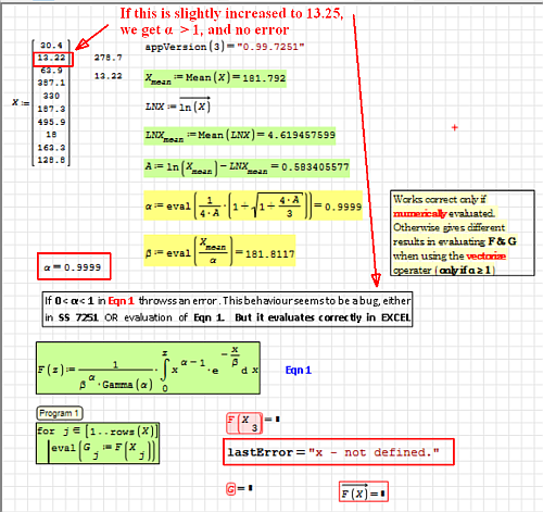

#28 Posted: 5/12/2020 12:55:50 PM
NDTM Amarasekera
NDTM Amarasekera
Gamma CDF function error revisited.
Following issues observed while trying to calculate SPI for a different set of data.
1. Gamma CDF function fails if 0 <'alpha' < 1
2. Even Razonar's method fails in such a situation.
3. According to the literature on calculation of SPI, the Gamma function is valid
for all 'alpha' values > 0.
4. No such issues in Excel or Mathcad.
5. Attached example is only to demonstrate the issue.
For the attention of authorities.
Gamma_CDF_Error_with_Alpha less than 1_.sm (13.59 KiB) downloaded 1484 time(s).

#29 Posted: 5/12/2020 4:02:58 PM
Your integration is ill posed ... "x_undefined"

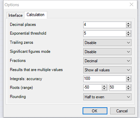

SMath native Gamma(x) 4 decimals and INT acc 50 have no impact.
Try your own alpha/beta.
Page1 NDTMA.sm (13.24 KiB) downloaded 1629 time(s).

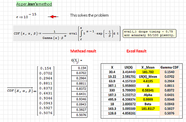

NDTM Amarasekera 5/13/2020 1:12:00 AM
#30 Posted: 5/13/2020 12:40:30 AM
NDTM Amarasekera
NDTM Amarasekera
Thank you Jean. Your suggestion to introduce ε=10^{-15} as lower limit of integration
solved my problem. But still the error persists if lower limit is zero.
A beginner may be confused and/or discouraged in a similar situation.
Gamma_CDF_Error_with_Alpha less than 1_SOLVED.sm (106.47 KiB) downloaded 1444 time(s).

#31 Posted: 5/14/2020 8:18:01 AM
1,443 likes in 2,936 posts.
I see the issue... when alpha < 1 and t = 0 smath has 1/(0^(1-alpha)) and the numerical integrator fails. I'm not sure about how ccould be fixed.

#33 Posted: 5/14/2020 5:09:31 PM
All that is not as simple as the BigBang theory.
If the first computed 'x' appears in data < 10^-15
the quick plot rejects, no complain ... didn't check X_Y plot.
Thus: zero min value 10^-15.
Just experimented on Bézier/Bernstein project.

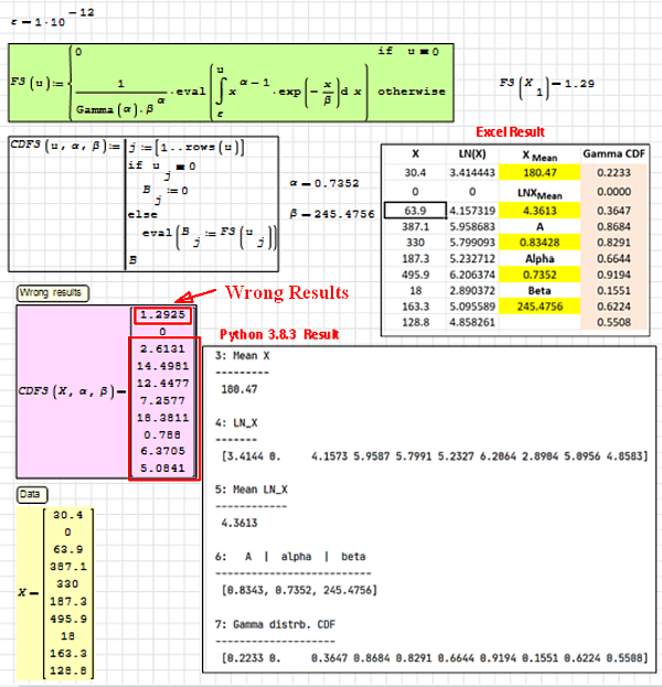

#34 Posted: 5/19/2020 5:49:32 AM
NDTM Amarasekera
NDTM Amarasekera
Looking for improvements in the Gamma function..
A few more issues please.
Gamma_CDF_Error_Wrong_Results.sm (334.88 KiB) downloaded 1504 time(s).
#35 Posted: 5/19/2020 8:26:46 AM
Freak 7251 does not open !
You just have two values: α:=0.7352, β:=245.7456
That's enough to simulate/evaluate CDF.
CDF Gamma.sm (262.81 KiB) downloaded 1431 time(s).
#36 Posted: 5/20/2020 1:41:58 AM
NDTM Amarasekera
NDTM Amarasekera
Sorry. PDF attached. Thank you Jean!
Gamma_CDF_Error_Wrong_Results.pdf (953.82 KiB) downloaded 877 time(s).
