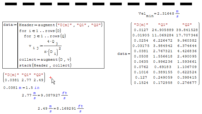

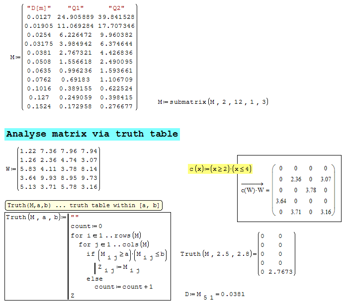

#4 Posted: 4/14/2016 12:58:57 AM
... brute force quick.

I think the simplest solution is to include a conditional "if" in the loop "for"

Just remove erroneous declarations, and use DS in function invocations (your D variable is defined having 11 rows, Q has 2 rows, you should use DS having 2 rows).
Vectorize and Program.sm (14.58 KiB) downloaded 1391 time(s).
P.S. My screenshot is just a follow-up of previous suggestions (Jean's and CBJ's).
My sheet is another approach without any loops, just vectorize() end eval().

Virus on fresh computer ... had to restart. Never let spouse, kids, etc on administration account ... "just to check email".
CBG is more of what I envisioned. I don't understand the array variable. Will need to put in my sheet to fully understand. I was going about it in a different way, this i better.

What's wrong with the counter? Getting "0" for first output, not 1.5.

CBG
CBG
78 likes in 312 posts.
You have an error, the "Line " command should be in the second loop.
Annex corrected fileVectorize and Program a_r1.sm (9.57 KiB) downloaded 1387 time(s).

Struggling with the matrices as I cannot figure out how to add components mid-way through the program loop. Right now, I drag down the handle, then individually cut and paste things down as necessary. If there is an easier way, please let me know
A little inspiration to conclude this project ...
  • CBG, you counter was what was perplexing me the most. This is originally what I was after Answer.smz (3.22 KiB) downloaded 1414 time(s).
  • Jean, you always say to be get inspired. After looking at your table, I expanded on my output Answer with Table.smz (3.64 KiB) downloaded 1424 time(s).
