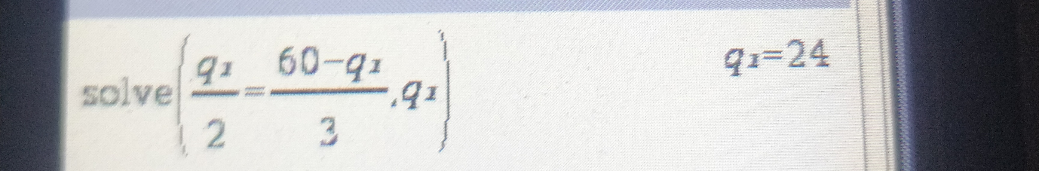

Is there any way to solve proportion's like in TI-nspire cx? (look at picture)

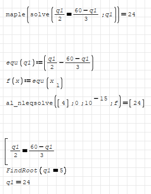

Oscar Campo 10/16/2022 11:15:00 PM
#3 Posted: 10/16/2022 2:18:32 PM
Mikko
Mikko
0 likes in 2 posts.
Thanks realy much this help lot!

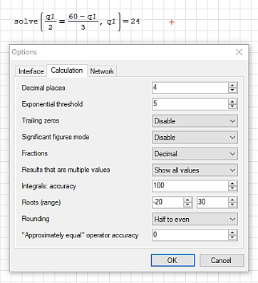

#4 Posted: 10/16/2022 8:52:58 PM
1,139 likes in 1,805 posts.
Hi. In addition to the churichurro solution you can also use SMath native solver after changing the roots range.

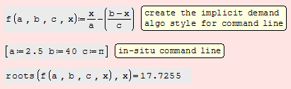

#6 Posted: 10/17/2022 7:41:28 AM

#8 Posted: 10/17/2022 10:13:40 AM
600 likes in 1,381 posts.
In addition to Razonar's reply;
You can also determine solve() range within the function itself.
You can also use roots() and FindRoot().

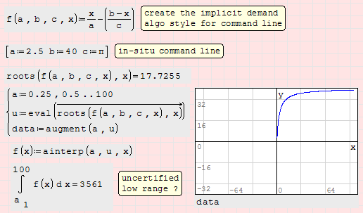

#9 Posted: 10/17/2022 7:49:42 PM
... get more, no sweat.
