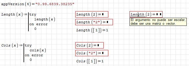

WroteThere are not try-catch here.
There are not too many applications in this forum.
It works numerically ... visit this application.
Image Rotate RGB Copy.sm (349.18 KiB) downloaded 1361 time(s).

Described behavior of the try...catch is by design.
In your example length(x) calculated symbolically and does not raise an error. You can check it by calculating length(x) with symbolic optimization.
To have the behavior you want please use eval(lenght(x)) instead.

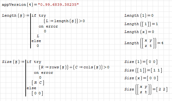

WroteDescribed behavior of the try...catch is by design.
Hi Andrey. Thanks for the clarification. I guess that the origin of this behavior is from about which is the "default unassigned variable type" in SMath. In maple and mathcad it is a complex number, but in SMath it seems to be a matrix or anything else:
If this is the case, it's correct to return rows, cols and length as an error in numerical evaluations and unevaluated form in symbolic ones.
For other side, it seems that if actuate like having something like evalb (maple's eval boolean), forcing the numerical evaluation, as it is showed in the yellow regions, and widely apply in the attached. This behavior is very useful, at least to me, because enable following routines for Length, Rows, Cols, IsMatrix (without using num2str which causes some issues for some applications) and others useful tools, which yield the same result for numeric and symbolic evaluations, making more easy the live to me.
Length.sm (61 KiB) downloaded 1383 time(s).

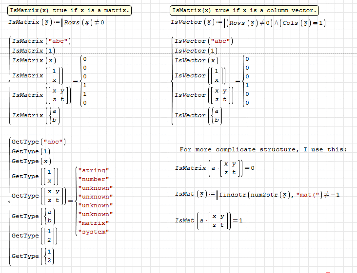

... plenty of things will reflect in "on-error"
Maths on_error.sm (15.54 KiB) downloaded 1347 time(s).
#11 Posted: 10/31/2018 10:06:16 PM
Hi Davide. Thanks for your answer.
Good to know. So, the results for rows, length, etc. it's correct. I don't have enough time nor ideas about how to test try...on error function, but guess that it is correcto too.
Thanks for the suggestion. But don't know what could be more convenient. For instance, maple have evalb (booleans), evalm (matrix, but obsolete in news versions), evalc (complexes) and some others for modify the way that evaluations are done. Also, the eval maple's function is like the "at" function in the Custom Functions plugin. So, maybe instead of modify rows and those functions, could be more practical introduce a second argument for eval, of the type of "complex", or "scalar", or "matrix" or things like this. Or maybe there are some simplify function under development which can handle those cases, or ... I actually don't know enogh for say which is the best path to follow.
Unassigned variables are considered as unknown type; there were problems in the past because they were consider scalar or matrices...
I suggest to open a separate correction request here or in the bug tracker to improve behavior of length/rows/cols when a matrix contains unknowns...
