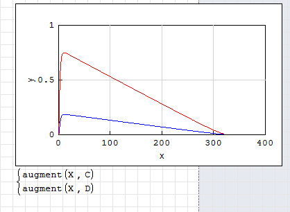

The max span is 0..10 Else attempt gives either two types of error.
The setup is correct but the result is a bit short of production.
Designers: that is just a report for your bed time thinking.
Cheers, Jean

Hello Jean,
Why don't you use stiff solvers, for example from DotNumerics plugin. They will cope with this equations well (dn_AdamsMoulton, dn_ExplicitRK45, dn_GearsBDF..).
P.S. By the way, uni made many ode solvers in few plugins, and I think SMath is very good regarding ODE solvers

Thanks Radovan,
Here is well done, Jean
ODE HIRES.sm (41.06 KiB) downloaded 1318 time(s).
