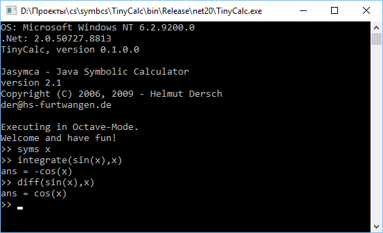

It is practically possible to use the available sources, but people are needed who will do this.
#4 Posted: 11/9/2020 4:31:59 PM
... try Sagemath, freeware. Pretended as powerful as Maple.
#5 Posted: 11/9/2020 5:32:58 PM
1,547 likes in 1,861 posts.
SMath Studio works on different platforms (Windows, Linux, iOS, Android, web ), so the source code should support this in the same way.
It is very difficult to include other sources if they are not in С#. Therefore, it only makes sense to consider projects in C# for these purposes.

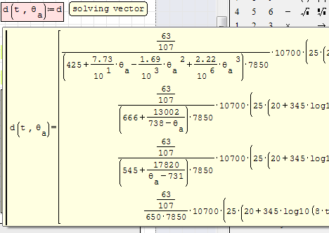

#6 Posted: 11/10/2020 12:34:11 PM
is it planned to use an symbolic library wihtin SMath without an plugin like the one for Maxima?
Smath has its own built-in symbolic.
Hover the cursor on a piece of maths to see the internal symbolic.
If you see an expansion, then type this piece of maths and Ctrl+. to expand.
