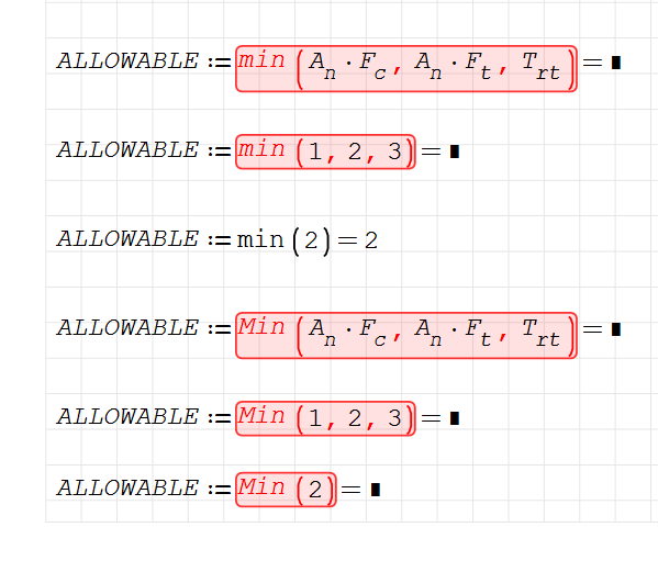

I'm struggling with the 'min' function. Could someone please point out where I'm going wrong? Thank you.

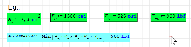

Hi nominal_diameter,
Try this way:

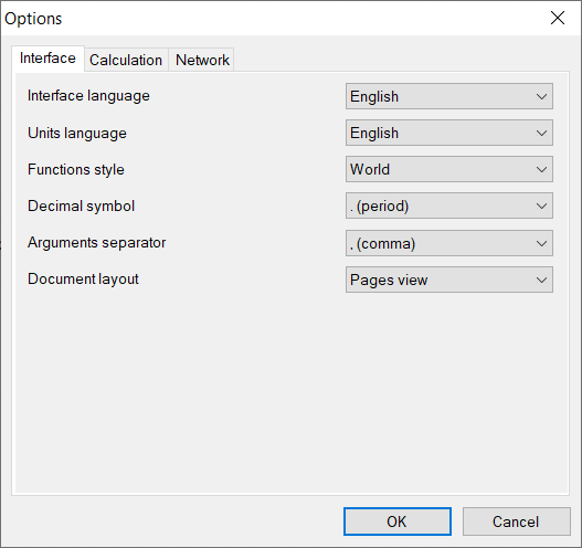

ioan92, the software won't allow me to use semicolons instead of comas, nothing happens when I push the semicolon button. How do I insert the semicolon?
Besides the semicolons, is there any difference that I'm missing?

Hi nominal_diameter
It is the use of the Min function rather than the min function that is important in this case.
The semicolon or comma is just the default separator for the list of values, set in the Tools menu under Options.

I've tried using the Min function and still get the same result. I also tried entering a string of numbers to see if that would work, but no luck yet.

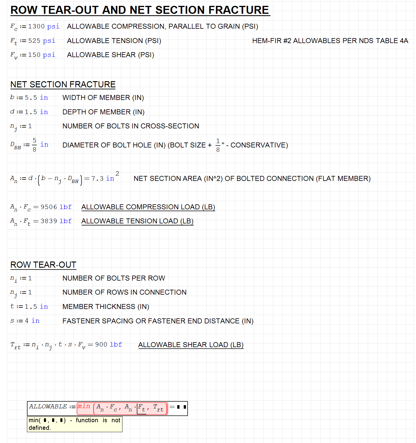

Hi Davide,
On both Min and min, the baloon says function is not defined.
Please load the attached file from my message and tell us what happens.
nominal.sm (4.2 KiB) downloaded 1770 time(s).
