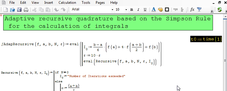

Here is an example of integration using the Simpson recursive adaptive method.
Adaptive_Recursive_Simpson_SS6179.sm (13.29 KiB) downloaded 1331 time(s).

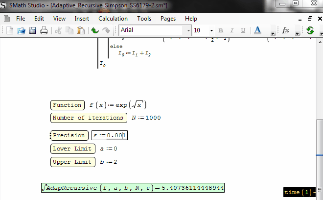

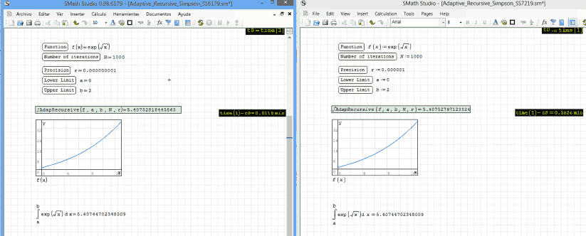

On the other hand, when running the algorithm in the versions of Smath Studio 6179 and 7219,
I realize that the SS-6179 version is more accurate than the current SS-7219, since the
first one allows an error of 0.000000001, while the latter only allows an error of 0.000001
Adaptive_Recursive_Simpson_SS7219.sm (14.55 KiB) downloaded 1289 time(s).
The SS-7219 version cannot calculate the function with an error of less than 0.000001 to achieve greater accuracy.
Are we going back?

My native SS 6179 supports ε:=0.0000000000001
@ equivalent accuracy, Romberg-Simpson kernel runs ~ 8 times faster.
Most puzzling from version to version
On my slow laptop:
Romberg-Simpson ..... 12 s
Simpson recursive ... 96 s
Simpson kernel in Romberg range [0..1] at decimation [n]
is most valuable on large range of the integration variate 'x'.
Thanks Carlos, most interesting ... Jean.
