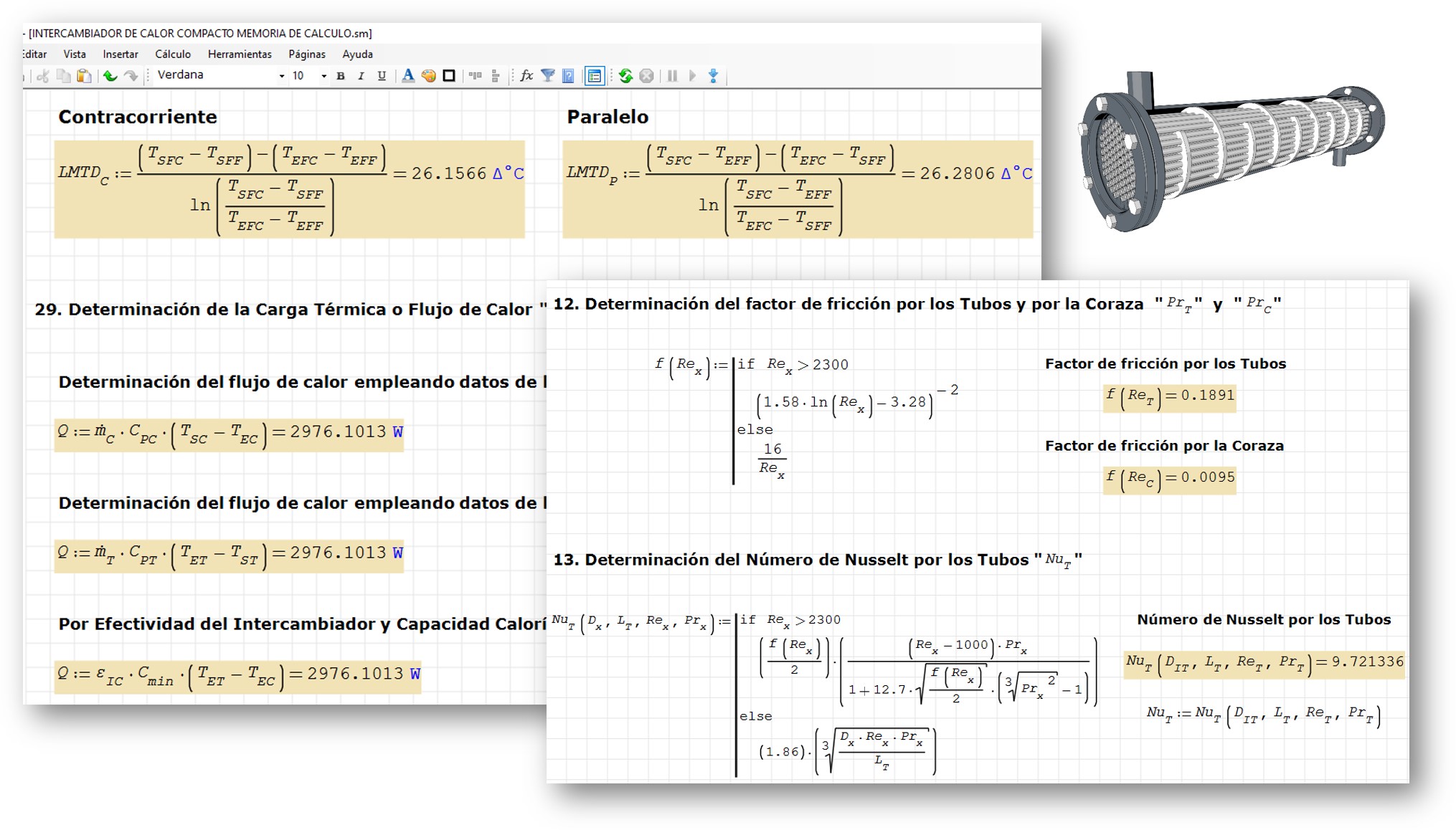

Hello friends, I want to share with you this calculation memory, for a miniature shell and tube heat exchanger.
based on the bibliography Lee, H. S. (2010). Thermal design: heat sinks, thermoelectrics, heat pipes,
compact heat exchangers, and solar cells. John Wiley & Sons.
INTERCAMBIADOR DE CALOR COMPACTO MEMORIA DE CALCULO.sm (10.51 MiB) downloaded 1626 time(s).
