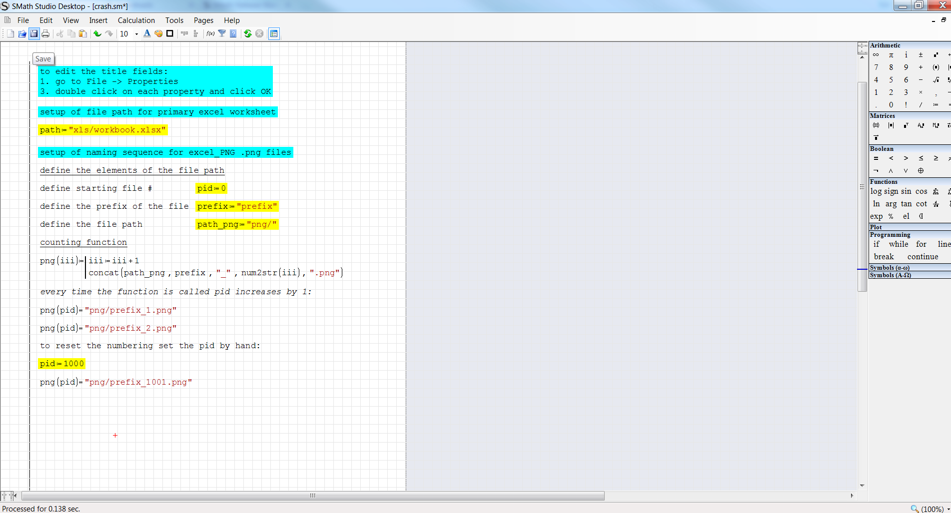

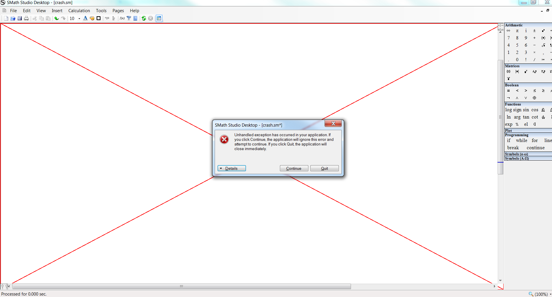

If I try to save attached file with the cursor positioned below all the text, it will crash.
Crash is related to presence of page background image bg.png.
Fresh install of this release is used on Win7 Enterprise SP1 64 bit.
I am encouraged to use company logo / title block on all my work so I will revert back to 0.97 till this is resolved.
crash.sm (38.4 KiB) downloaded 1741 time(s).
Fixed. Thank you!
