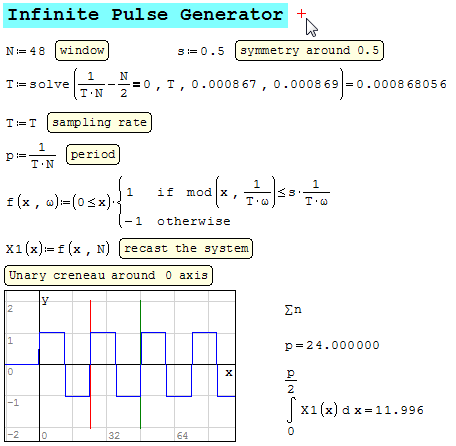

#1 Posted: 5/24/2018 10:29:14 AM
More in the attached Smath document.
Maths Pulse [Square].sm (31.39 KiB) downloaded 1078 time(s).

Augmented version.
Maths Pulse [Square].sm (42.53 KiB) downloaded 1049 time(s).
