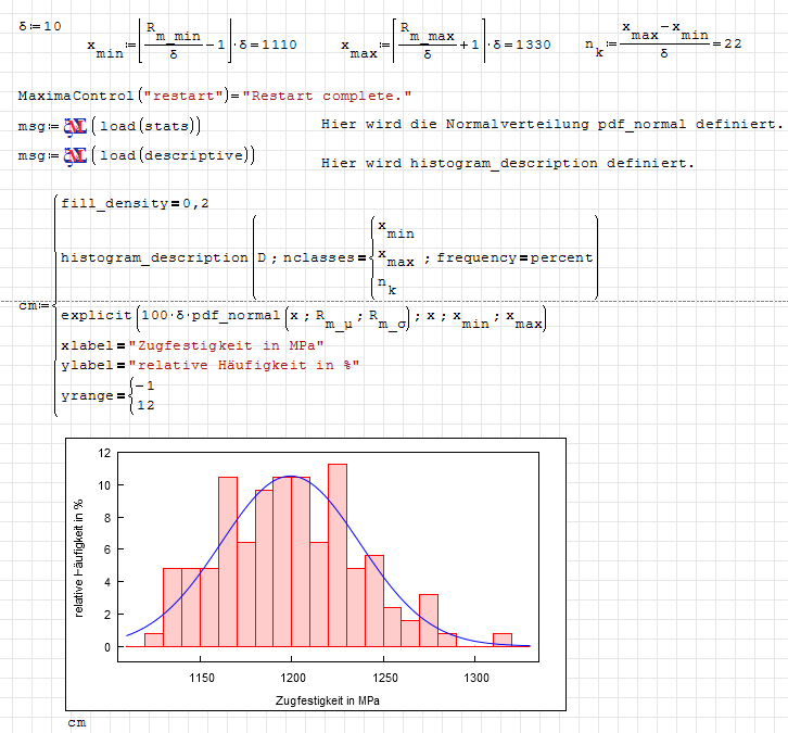

I would like to know if is there a function equivalent to MathCAD's 'histogram' function in SMath. I am willing to plot a histogram from data gathered from Excel but I could not find such function in SMath. Does anyone know a plugin or a function which could help me out doing so?

Here is an example adapted from a book on materials science with mathcad, using the maxima plugin and loading additional maxima packages.
Streuung.zip (20.91 KiB) downloaded 453 time(s).
