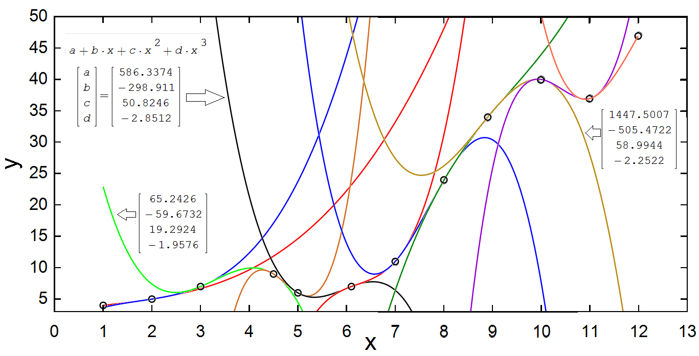

As a temporary solution:
Click to enlarge
linterp-xyplot-using-defined-argument.sm (21.7 KiB) downloaded 1543 time(s).
interp(), ... functions from Mathcad Toolbox still have a bug. The implementation used does incorrect interpolation on some intervals. I don't know how to fix this yet, because the algorithm was restored according to the article and perhaps it was done incorrectly.

Is that bug only related to non-equidistant points? In that case, the functions would still be good enough for the ode solvers, at least for rkfixed()
#7 Posted: 12/12/2023 7:56:30 PM
Is that bug only related to non-equidistant points ?
The lspline(X,Y) produces the wrong vector
k ... [0 3 0 0 0.6629 ...suite OK]
k ... [0 0.6629 ...suite OK]
Put the right vector in interp(k,X,Y,x) fails.
Simply a bug ... reflexive double bug.
Jean Giraud produces useless messages.

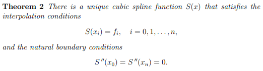

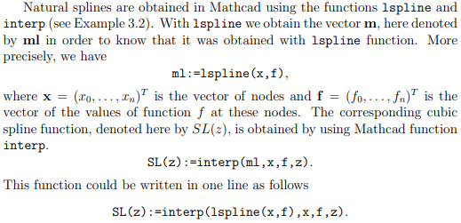

I will remind you of this document, which describes how the functions work. My implementation of interpolation has an error, but the coefficients themselves seem to be calculated correctly.
In Mathcad the first three numbers encode the type of spline. Jean doesn't know about this.
Cubic spline interpolation using Mathcad (2009).pdf (256.71 KiB) downloaded 2756 time(s).

Yes, my comment is about that the lspline and pspline names could be sort of confusing, because, as the report says, mathcad's lspline, pspline and cspline are all "cubic splines". The "l" in "lspline" is not for linear interpolation, but for linear ends conditions, also called natural conditions. The "p" is for parabolic, and the "c" for cubic, all meaning ends conditions too.
Thus, Mathcad lspline is not related with SMath linterp or maple spline(X,Y,x,linear)
As usual. Yes, I know. You can also find here an adaptive spline interpolation using that encoding.
