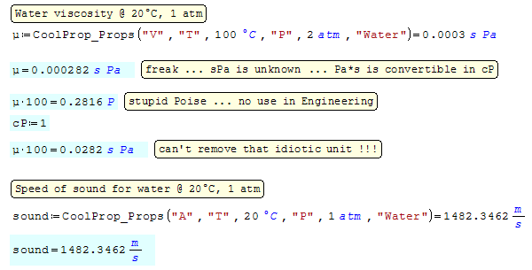

From design or else wrongdoing the built-in unit system should
be evaporated to avoid idiotic results.
I Consulted for years with my Ti-58/59 w/o units.
Inst_Viscosity Water.sm (43.72 KiB) downloaded 1543 time(s).

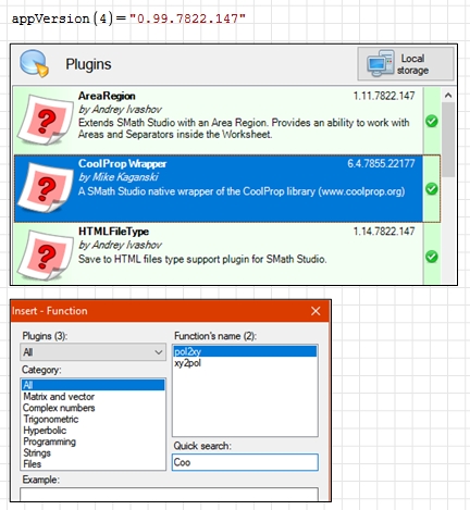

It's true, functions are not loaded. I have tested the plugin with local build. Something goes wrong when building on the server. I asked Andrey about it.
Alvaro 7/5/2021 4:33:00 AM

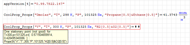

Maths CoolProp_Props SpeedSound.sm (28.25 KiB) downloaded 1543 time(s).
