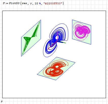

Hi. For show the four plots at once.
DadrasAttractor.sm (46.22 KiB) downloaded 1230 time(s).
Fridel Selitsky 7/27/2021 3:46:00 AM
#6 Posted: 7/27/2021 2:58:38 AM
Thanks for the 3D image
