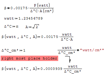

#6 Posted: 9/7/2010 4:40:39 PM
maweilian
maweilian
5 likes in 103 posts.
A picture is worth a thousand words:
click on the placeholder on the right and press the apostrophe " ' " to insert a unit:
type in "N * m" (use the dynamic help to make sure you are using the predefined units):
that should give you the units you desire:
Will Massie Mechanical Engineer Oregon, USA

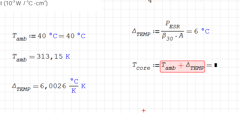

#8 Posted: 9/28/2019 7:17:24 PM
Juan Manuel
Juan Manuel
0 likes in 14 posts.
Hello, I would like to consult you
                                                I define a temperature in degrees Centigrade, when I call it it looks like Kelvin degrees and then I can't make a sum because it tells me they are two different units. How can I do so that the defined temperature is maintained in every calculation in the unit that defined it?
Attached image capture of the problem.
Thank you

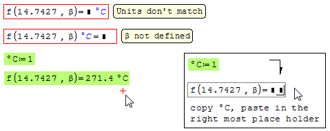

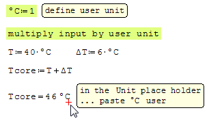

#10 Posted: 9/29/2019 7:46:27 AM
Smath Unit System is ISO, °C is not ISO.
Define your user unit.
If user unit is not '1', don't multiply input by user.
frapuano 9/29/2019 8:28:00 AM

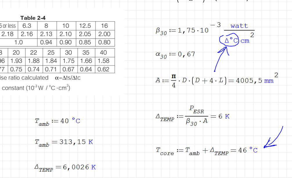

#11 Posted: 9/29/2019 9:37:54 AM
Visit Colebrook, suggestive how to carry Engineering projects.
And recover units in the results. Each project is specific.
Please, feel free to attach your project for more doctoring.
Inst_Colebrook Pipe Data.sm (61.76 KiB) downloaded 1200 time(s).

#14 Posted: 9/29/2019 7:03:50 PM
ry practice ignoring unit system.
Only OK for baby stuff: 2*2=4m²
#15 Posted: 9/29/2019 10:06:13 PM
The difference operator is often useful.
