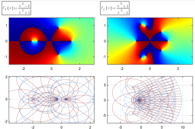

Hi. The attached shows how to plot complex functions plotting a colormap of it's argument, and how to interpret that plot.
ComplexColor.sm (63.65 KiB) downloaded 1498 time(s).
ComplexColor.pdf (1.72 MiB) downloaded 965 time(s).

And the more classical complex map.
ComplexMap.sm (49.67 KiB) downloaded 1464 time(s).
ComplexMap.pdf (1.2 MiB) downloaded 867 time(s).

Both toghether with an improved complex map. But the previous reamins because can be useful for simple functions, as it is faster ( For compare can be seen https://www.wolframalpha.com/input/?i=complex+map+ln%28z%29 )
ComplexCharts.sm (106.58 KiB) downloaded 1538 time(s).
ComplexCharts.pdf (2.35 MiB) downloaded 954 time(s).
