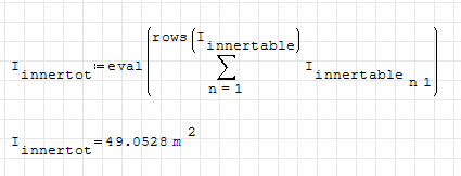

I'm I doing something wrong or am I actually above the maximum allowed positive number? Is there a way around this. To me the number doesn't seem vary large but I'm probably missing something.
Here is a screen shot and file is attached
Thanks,
Ryan
Max Positive.sm (21.11 KiB) downloaded 1427 time(s).

who knows...
use eval() to avoid this issue...
