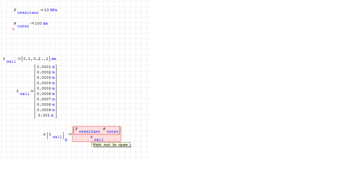

#1 Posted: 7/4/2020 2:00:34 AM
Trip
Trip
0 likes in 4 posts.
I have looked into vectorizing and tried cross product but I can't figure out how to return a matrix (and eventually a graph) of the function that is a dependent on the variable twall. Any help is appreciated. I'm trying to save money by using this program but it is harder than MathCAD to figure out the errors.

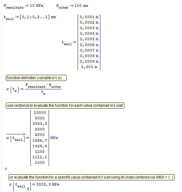

#2 Posted: 7/4/2020 6:24:48 AM
127 likes in 342 posts.
Try like this

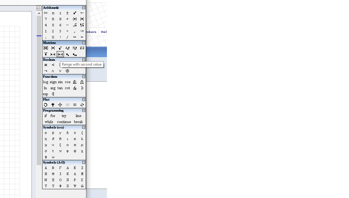

#5 Posted: 7/4/2020 7:10:52 AM
Trip
Trip
0 likes in 4 posts.
Now I re-found the range operator here:
#6 Posted: 7/4/2020 7:23:48 AM
Trip
Trip
0 likes in 4 posts.
I follow your keystrokes but I get error messages for the function I define and for the vectorized function. Any ideas?

#8 Posted: 7/5/2020 12:11:48 PM
1,134 likes in 1,805 posts.
Hi Trip. It seems that you are using matrices subscripts instead dot subscript in the variable t. This make that sigma isn't well defined, and thus can't be vectorized. If you upload your file I'm sure that someone can tell you what's wrong.
#9 Posted: 7/5/2020 2:48:58 PM
If you just want it to work ... Jean
rangeUNK.sm (8.22 KiB) downloaded 1457 time(s).
