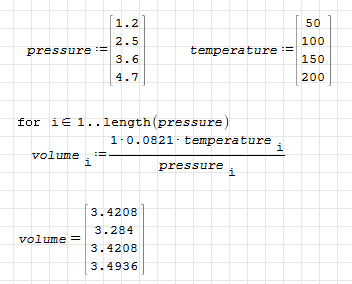

Could you tell me if their is any way to loop through a list the Way mathcad does with the I:=0..n, as a "global" methode (not inside a formula).
Below a screenshot of the case
Image explicative
Thank you for your help

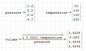

#6 Posted: 11/16/2017 3:01:37 PM
1,443 likes in 2,936 posts.
Here you have:
The arrow over the math is the function vectorize(), and that's what you need to apply the elements of the ranges avoiding loops (that is the other way to accomplish the task)

#7 Posted: 11/16/2017 3:14:25 PM
pierre
pierre
2 likes in 17 posts.
Thanks a lot for the explanation!
You made my day!
