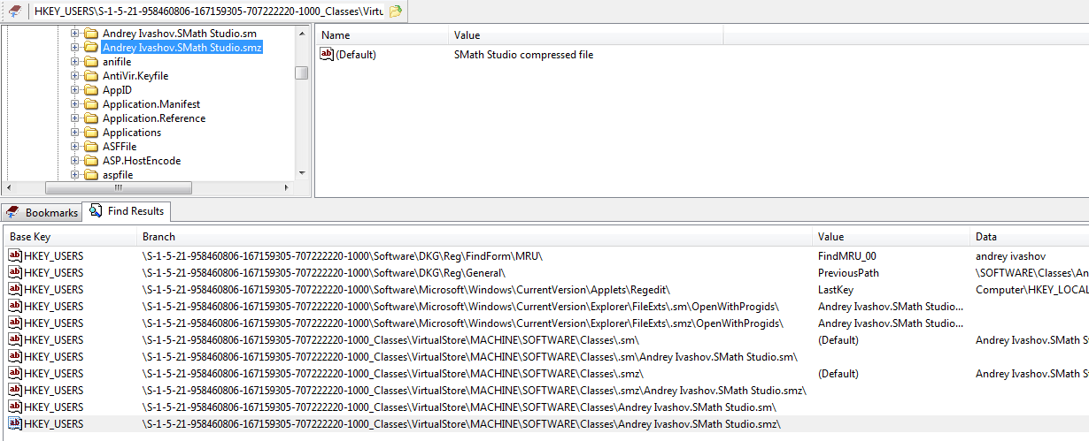

Since I have installed Smath Studio, AdwCleaner found four suspicious registry keys. Here is the report :
Quote
# AdwCleaner v5.114 - Rapport créé le 29/04/2016 à 10:48:50
# Mis à jour le 27/04/2016 par Xplode
# Base de données : 2016-04-27.1 [Serveur]
# Système d'exploitation : Windows 7 Ultimate Service Pack 1 (X64)
# Nom d'utilisateur : ****************
# Exécuté depuis : ***************
# Option : Scanner
# Support : http://toolslib.net/forum
***** [ Services ] *****
***** [ Dossiers ] *****
***** [ Fichiers ] *****
***** [ DLL ] *****
***** [ WMI ] *****
***** [ Raccourcis ] *****
***** [ Tâches planifiées ] *****
***** [ Registre ] *****
Clé trouvée : HKCU\Software\Classes\Andrey Ivashov.SMath Studio.sm
Clé trouvée : HKCU\Software\Classes\Andrey Ivashov.SMath Studio.smz
Clé trouvée : HKU\S-1-5-21-295457093-2378653176-778422176-1000\Software\Classes\Andrey Ivashov.SMath Studio.sm
Clé trouvée : HKU\S-1-5-21-295457093-2378653176-778422176-1000\Software\Classes\Andrey Ivashov.SMath Studio.smz
Is it positive falses ?
Pekoe
#2 Posted: 5/3/2016 1:42:44 PM
1,442 likes in 2,935 posts.

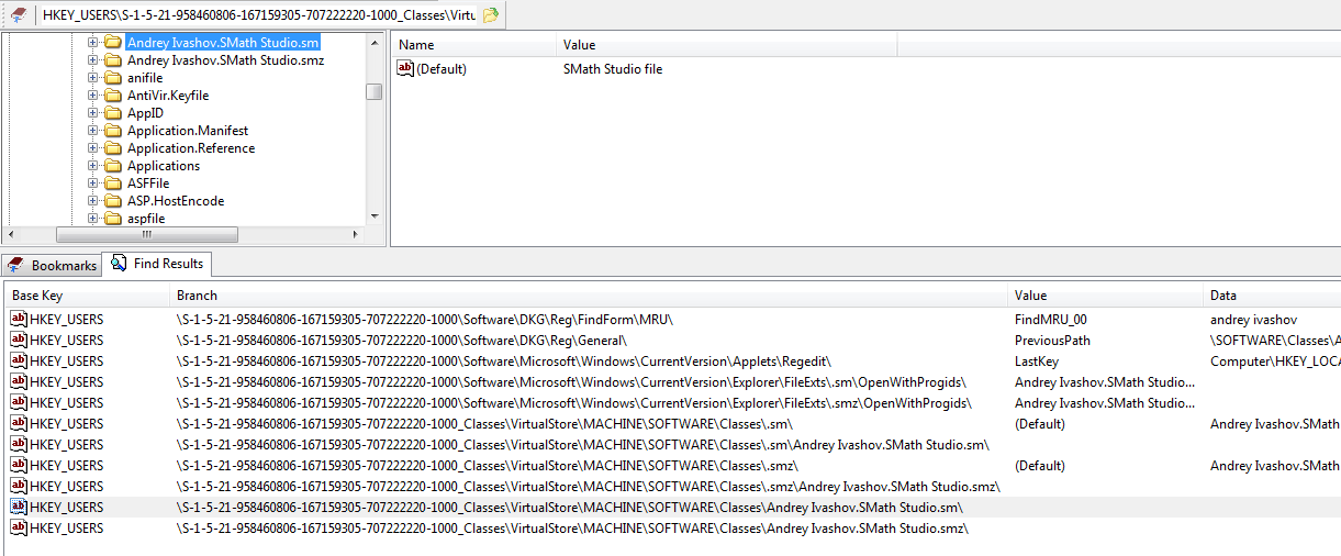

These are registry keys about file type description for the current user
Quote
HKCU - Abbreviated from the registry key name HKEY_CURRENT_USER. HKCU stores settings that are specific to the currently logged-in user. The HKCU key is a link to the subkey of HKEY_USERS that corresponds to the user; the same information is reflected in both locations.
Quote
HKU - Abbreviated from the registry key name HKEY_USERS. HKU contains subkeys corresponding to the HKEY_CURRENT_USER keys for each user registered on the machine
#3 Posted: 5/3/2016 2:24:43 PM
Pekoe
Pekoe
1 likes in 3 posts.
Thanks for this precise answer.
I posted a similar question to the Toolslib Forum but no answer until now. I hoped they put these keys in a white list (no option for the final user). It seems that AdwCleaner is a little bit paranoïd (obviously, it's a safe attitude)...
If not, is it possible to erase these keys in the registry (either by AdwCleaner or directly within the registry, using regedit or other) without disrupting Smath ?
Best regards/Cordiali saluti
Pekoe
#4 Posted: 5/3/2016 2:38:38 PM
You are very welcome
I suppose it depends because one may write almost everything in the registry, following is own "pattern", thus is not easy to have precise answers valid for every case.
100% agree
Not sure, we may wait an answer from the author, but if possible would be better to put it in a local whitelist (if the software let you do it).
