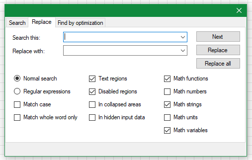

Hello friends. Is there a search/replace function in sMath Studio? Sometimes you decide to change a variable name from x to x1, for example. If there is a “search, replace all”, then you don’t have to do it one by one and it will save a lot of time.
#2 Posted: 1/20/2018 4:37:36 AM
1,442 likes in 2,935 posts.
In a region, you can use the F8 key an you'll be able to rename all local variables/functions at once.
Globally, you can do it with the Text Region Utilities plugin.

Andrey Ivashov 1/20/2018 10:13:00 AM

Hello Davide,
Thank you very much for your help. I downloaded 2 files: TextRegionUtilities.csproj and TextRegionUtilities.sln. How do I install them in sMath? And how do I use them to “replace all”?
Thank you again friend.
#4 Posted: 1/25/2018 6:31:48 AM
In your Smath Studio, go to: Tools > Plugins... > [switch the top-right button: Local Storage > Online Gallery] and search the plugin, then double click it or click on the install button, that's all
