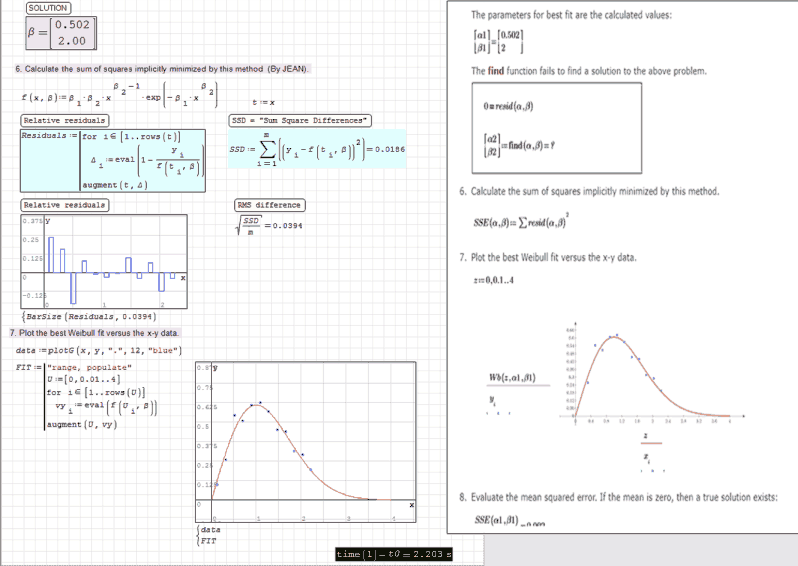

Reviewing the Levenberg Marquardt Method with a Jacobian matrix for finite differences,
solving an example taken from the website:
http://support.ptc.com/help/mathcad/en/index.html#page/PTC_Mathcad_Help/example_using_minerr_for_nonlinear_least_squares_fitting.htm .
Algorithm_Levenberg_M_with_DF_SS7251.sm (210.01 KiB) downloaded 1330 time(s).
Algorithm_Levenberg_M_with_DF_SS7251.pdf (569.73 KiB) downloaded 836 time(s).
Carlos

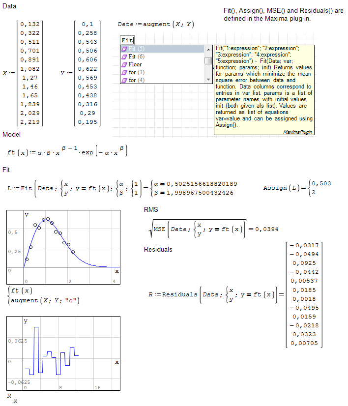

Solution using the Maxima package lsquares via the interface functions of the Maxima plugin
fit1.sm (29.42 KiB) downloaded 1318 time(s).
frapuano 12/21/2019 3:16:00 PM, Radovan Omorjan 12/21/2019 10:36:00 AM

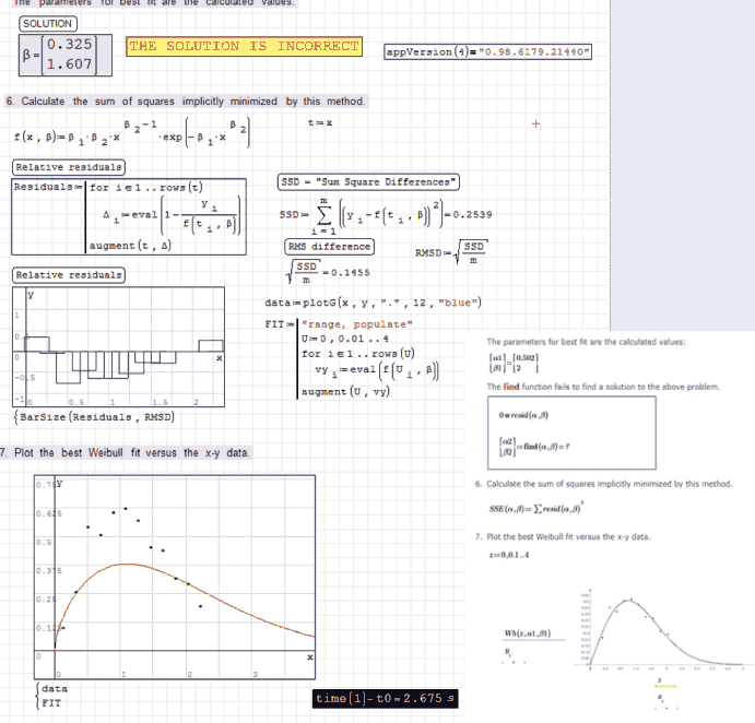

Hello Jean:
I tried to run the algorithm of Levenberg Marquardt, in the version of SS6179,
but it inevitably fails, giving an incorrect solution.
It seems that the error could be in some operation where a single value vector
is produced. Could you take a look to see if you can doctorate ?.
I post again the version of the algorithm in SS7251 with some minor changes.
Algorithm_Levenberg_M_with_DF_SS6179.sm (513.58 KiB) downloaded 1359 time(s).
Algorithm_Levenberg_M_with_DF_SS7251_R1.sm (209.94 KiB) downloaded 1362 time(s).

The question is: Why does the SS7251 version directly obtain the solution,
changing the values correctly of the β variable, while the SS6179 version does not,
and they have to be manually entered as new values of the vector of the assumed initial solution. ?
The algorithm is the same for the 2 versions of SmathStudio, so what is the difference if the
programming and decision definitions are supposed to work the same?
Carlos

A most interesting observation !
SS 6179 may have to do with the conditional statement.
SS 6179 is "zero" tolerance. So, it may just navigate then end.
It could be SS 7251 conditional is coded more tolerant
Mathcad style and reaches convergence ? Watson, are you there ?
Cheers Carlos ... later on.

Hola Carlos. Just check the code from the SS6179 version, in the while not(stop) loop, the line with A:=J^T*f is wrong, it must to be A:=J^T*J.
NDTM Amarasekera 12/27/2019 7:17:00 AM
#11 Posted: 12/27/2019 3:47:32 PM
Thanks Alvaro ... doctored !
Weibull LM [0.1,1] 1 min
Weibull CG [0.1,1] 2.3 sec ... ½ max residual deviation
Carlos, your very original LM [Pharmacokinetics] works faster.
an it be compacted algo style ... tried not to avail ?
Hola ! Avaro, Carlos ... Jean
Genfit Weibull [LM_Iteretive CG].sm (437.44 KiB) downloaded 1145 time(s).
Genfit [Algo Minimize(L-M)].sm (116.99 KiB) downloaded 1141 time(s).
#12 Posted: 12/27/2019 8:37:54 PM
CBG
CBG
78 likes in 312 posts.
Hola Alvaro.
Muchas gracias por tu corrección.
Cuando copie y pegue directamente el codigo de SS7251 a SS6179 daba el error de
"Ecuacion demasiado larga para visualizarla" con un tiempo de ejecusion de mas de 7 minutos,
por lo que opté por copiar manualmente el codigo, pensando que las declaraciones eran interpretados erroneamente, y
fue cuando copie mal la formula.
Hello Alvaro.
Thank you very much for your correction.
When copying and pasting directly the code from SS7251 to SS6179 it gave the error of
"Equation too long to display" with an execution time of more than 7 minutes,
So I chose to manually copy the code, thinking that the statements were misinterpreted, and
It was when I copied the formula badly.
Muchas gracias tambien a Jean por su apoyo y sus comentarios tan acertados.
Carlos

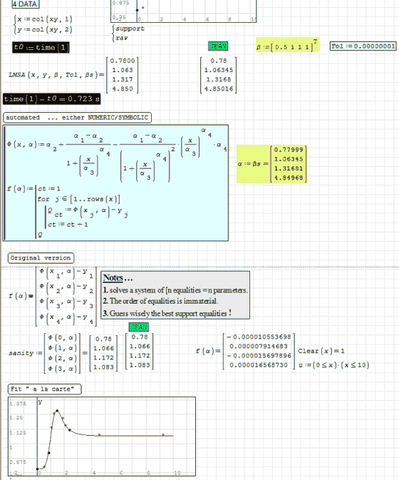

my god.. i didn't know this was a thing!
1. al_nleqsolve fits the model through selected equalities.
The data set may be moderately noisy.
2. GenfiMinimize is essentially the Cholesky LS solver.
My collection is not lean [177 documents ...some duplicates].
Genfit linfit HyperRobust [Ge Crystal].sm (81.8 KiB) downloaded 1125 time(s).
Genfit [Algo Minimize(al_nleqsolve Alco, Thurber)].sm (85.91 KiB) downloaded 1121 time(s).

#18 Posted: 1/15/2020 3:39:52 PM
Unfortunately, version SS6179, for unknown reasons
does not solve the first example, and results in the
same starting solution vector, the other examples are
solved without problem.
Hola ! Carlos.
You don't specify if the SS 7251 solves that example.
Please, don't drop dead at reading.
This example attached, Mathcad [L-M, CG, QN] does not even
return the exact coefficients. I tortured myself on that.
On the other hand as well, many model functions can't be
fitted from being too much reflexive within themselves.
For those non willing fit, al_nleqsolve will generally succeeds.
Mathcad failed as well the ITER Cadarache Cu resistivity.
Was done otherwise via sub methods. At least for ITER,
Mathcad returned: "Too complicated to solve"
u:=(0≤x)*(x≤10) useful constrain the Quick plot.
Thanks for your immense dedication.
Genfit [Algo Minimize(al_nleqsolve Pharmacokinetics) ... AUTOMATED] Copy.sm (104.24 KiB) downloaded 1070 time(s).

10 ^ -8 can be used, in both cases, the starting vector is [0.5 1 1 1].

The idea was to run the LM algorithm as a function for SS7251 and SS6179, for which
use your examples.
Jean, I tell you that I take the results you show in your exercises as the exact or correct ones
Thank you
Carlos
frapuano 1/16/2020 8:16:00 AM
#20 Posted: 1/16/2020 3:35:31 PM
They are all correct, good fit from model.
There are many more techniques to best fit by region(s)
The last example SS 6179 spits the fit very fast vs other
solvable previous examples ... supports tol 0.00000001.
Comfort yourself: model fit needs no more than 6 decimals
or less ... from zillions done.
Thanks Carlos for your doctoring expertise.
