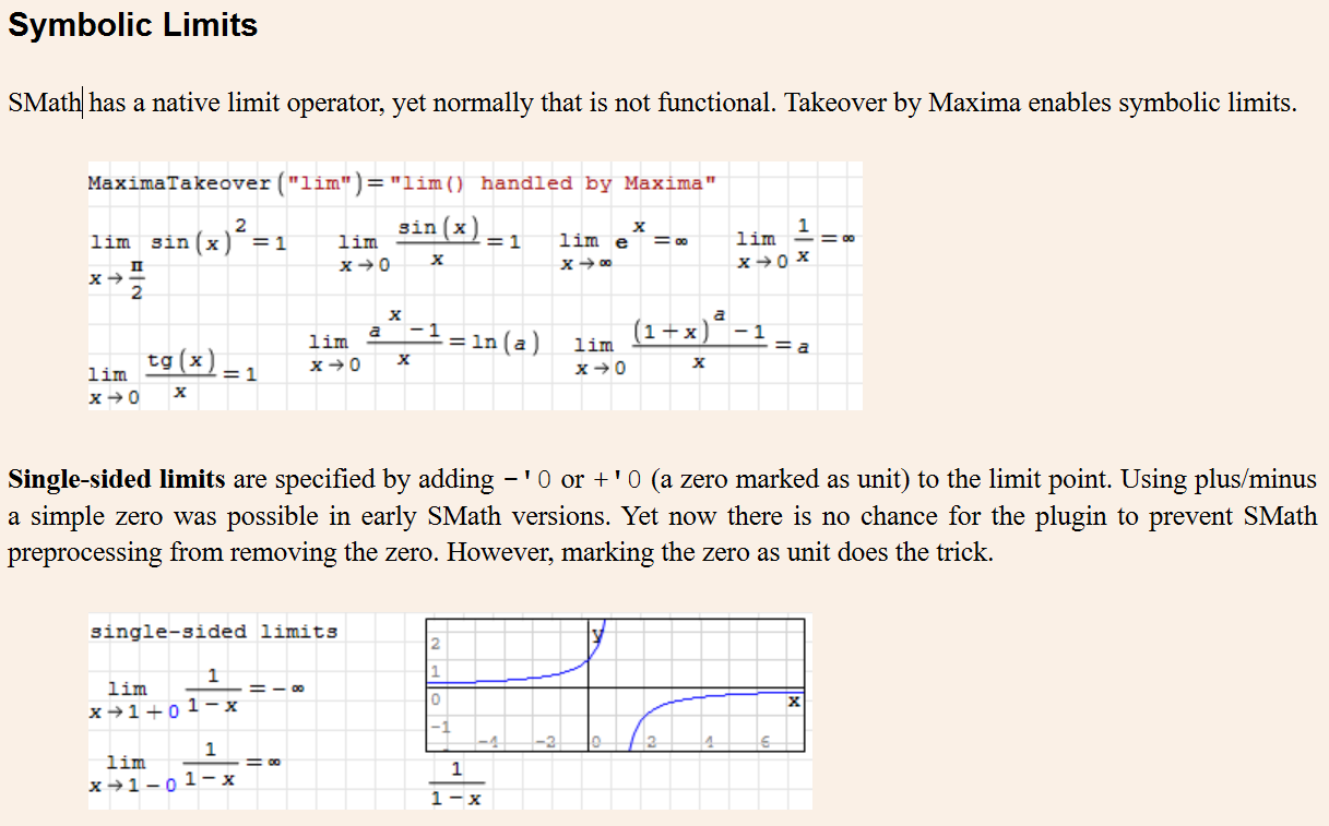

The Maxima plugin can handle limits symbolically. Below you find a preview of the SMath with Maxima handbook, it is to appear with the next release of the Maxima plugin. Ordinary limits work in the current version. Single sided limits will be part of the next release.
2023-09-11 06_50_04-C__FHB_Software_SMath_SMath Skript_SMath with Maxima.lyx - LyX.png

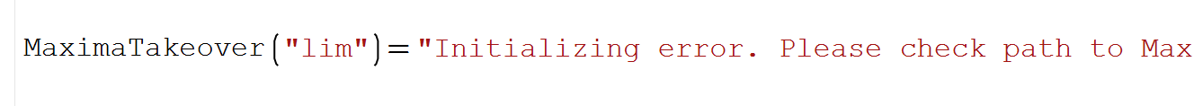

But I have
Send please the SMath-file
#4 Posted: 9/11/2023 12:34:09 PM
Oscar Campo
Oscar Campo
135 likes in 309 posts.
Thanks!
But I have
Do you have maxima installed?
