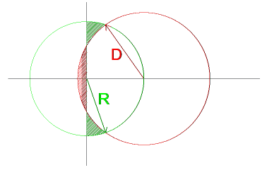

Is it possible to make a type of shading like the one shown in the figure?

It is possible to make a type of shading like the one shown in the figure
Thanks Carlos, superb.
You can have it shaded in all web colors as well.
I didn't add the arrows ... The two circles could
be done unicolor via rkfixed.
Maths Goat Radius.sm (132.01 KiB) downloaded 1246 time(s).

CBG, your algorithm for drawing a circle can be simplified.
Circle_HatchM.sm (30.98 KiB) downloaded 1237 time(s).

Beside Jean's random hatch, you can also fill a region with brute force algorithms, or using CreateMesh, with some restrictions (Origin must to be inside the region).
Circle_Hatch.sm (42.72 KiB) downloaded 1254 time(s).
