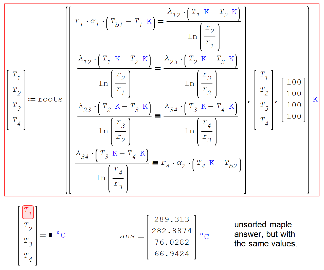

I would like to to sole the linear equations
F1=F2=f3=F4 with 4 unknowns T1, T2, T3 and T4
I can do it in Mathcad (given-find). but cannot in SMath ;-(
Help me please!
See please the Mathcad Calculation Server
http://twt.mpei.ac.ru/MCS/Worksheets/Thermal/Heat-Flow-3radius.xmcd
my SMath try in attach and
Lambda3.sm (434.36 KiB) downloaded 1378 time(s).
the picture

Hi. Here two options for solve the system.
Lambda3.sm (452.05 KiB) downloaded 1393 time(s).
Valery Ochkov 7/21/2024 3:29:00 PM, ioan92 7/21/2024 5:25:00 PM

#4 Posted: 7/21/2024 3:52:10 PM
StvMath
StvMath
44 likes and 1 dislikes in 71 posts.
I see Alvaro has beaten me to it, but here's my approach anyway.
Lambda3b.sm (470.18 KiB) downloaded 1446 time(s).
Valery Ochkov 7/21/2024 3:56:00 PM, ioan92 7/21/2024 5:24:00 PM
#5 Posted: 7/22/2024 12:16:52 AM
Valery Ochkov
Valery Ochkov
66 likes in 690 posts.
Thanks to all!
My solution in attach
Lambda3.sm (265.4 KiB) downloaded 1418 time(s).
