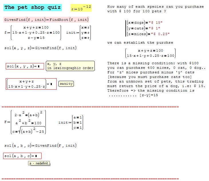

Greetings to everyone.
I have tried to solve a system of nonlinear equations using the "GivenFind" procedure. I've attached two screenshots below with the bugs returned by the program. In the first image, the program has returned: "x - undefined" error, as can be seen. I then defined the vector x, and the program returned the error "GivenFind - the function is not defined" as in the second image. What could be wrong?

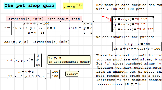

It is not an Smath procedure. The native procedure "FindRoots"
Which to me is a non sense as you are given something and want to find.
Solve GivenFind PetShop.sm (13.72 KiB) downloaded 1217 time(s).
Solve TREASURY_1 [Iterate L, Lc].sm (36.5 KiB) downloaded 1053 time(s).

Bonjour Jean Giraud.
I tried before, including the way you suggest it. In addition I analyzed some examples I found on the forum. The results were the same. I attach a new image to one of the examples you gave me in your answer. You may notice a similar error. Therefore, please help me solve the problem.
#4 Posted: 3/18/2018 4:05:29 AM
Just suppress evaluation of the marked region.

hello omorr.
The result is the same. I have not attached a new image. I specify that if I define the sizes x, y and z, the program returns the error "FindRoot - the function is undefined"

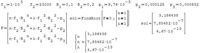

Here is a practical and very laborious way to solve the initial problem. The three basic non-linear equations are those on a yellow background. The MathCAD program's symbolic calculation facilities were used to solve two of the basic equations in relation to the η and λ variables. The necessary substitutions were made in the third equation and I was able to define the function N (n) in this way. The equation N (n) = 0 is solved using the "solve" function in Smath. A second function (Λ (λ)) was then elaborated which was solved in turn using the same function. Finally, one of the two equations solved in relation to the variables η and λ is actually calculated. The whole calculation process lasted about 60 minutes. I wonder how long it would take if I did not have the facilities of MathCAD's symbolic calculation ?! Probably a lot of hours. What would have happened if (as Radovan had said) the number of variables would have been greater than 3 ?! It would have been frustrating indeed. Therefore, if Smath developers read this post, I think it would be good to consider the possibility of implementing a "Given-Find" and / or "Given-Minerr" computation procedures similar to those used in MathCAD. I attached here along with the image of the Smath solution, a picture of solving the same problem in MathCAD by using the "Given-Find" procedure. It lasted only as long as it was necessary to edit the necessary relationships in that spreadsheet. Otherwise, all the best.

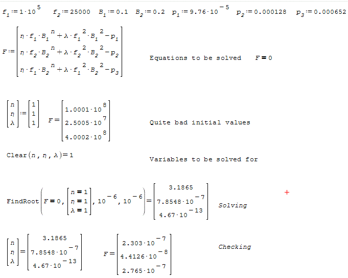

It seems that for your problem there is a solution (do not know if it is a viable one). FindRoot() will do the job here. One might consider FindRoot() similar to Given/Find in Mathcad.
FindRoot3.sm (13.61 KiB) downloaded 1155 time(s).

@Radovan: It works
@Jean Giraud: I can not comment. For now, I've managed to solve the problem. Another time I will see.

Please repost working sheet. I am not getting your solutionsFindRoot(ES).smz (2.97 KiB) downloaded 1199 time(s).

Here's the Smath file. The other was an image file.
FindRoot.sm (8.94 KiB) downloaded 1191 time(s).

This is a matter of third and fourth parameter of FindRoot() function (numerical precision). The solution will be different if you change them. Just look at the order of magnitude of the solutions. The second and third values are quite close to zero. Therefore, one might expect this behavior.

#20 Posted: 3/19/2018 1:28:46 PM
I don't think so ! Check I recomposed correctly.
GivenFind PossibleBug.sm (235.71 KiB) downloaded 1184 time(s).
