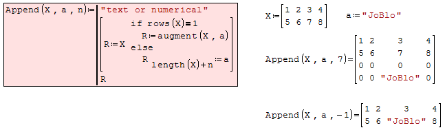

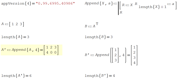

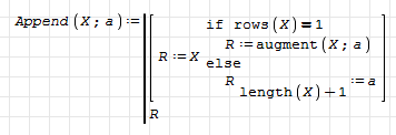

Hi. Is this the expected behavior?
Append.sm (6.87 KiB) downloaded 1342 time(s).
I hope not. I expect A' = [1 2 3 4]

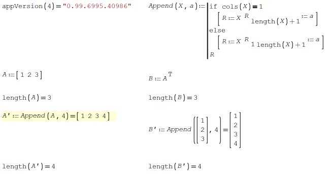

#3 Posted: 2/27/2019 9:53:45 PM
1,127 likes in 1,800 posts.

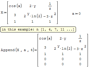

Hi Jean. Nope, maybe more like this:
BTW, this is a workaround. I expect this result but for the previous syntax.
#4 Posted: 2/27/2019 10:20:41 PM
You just append, my code inserts wherever needed.
My mistake I named Append(,,,)
OK, you are imitating MCD.
Simpler Append: transpose the row, stack, re-transpose.
#5 Posted: 2/27/2019 10:25:09 PM
I'm trying to imitate Wolfram's Mathematica Append.

#7 Posted: 2/28/2019 5:48:34 AM
1,443 likes in 2,936 posts.
Yes it is correct, or at least it conforms with the general approach of the program (vectors are single column matrices, anything else is a matrix). You might see it better in a 2 rows matrix:
The new indices are added expanding the matrix vertically; there is no special case for single-row matrices.

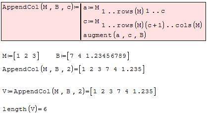

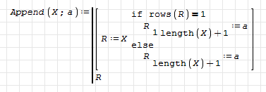

For your task, one way could be this:
Or this:

Close. Correct it's Saludos Jean.
Thanks for the explain. You give to me the rule for understand the result. Just as comment, matlab don't follow that, and gives this results:

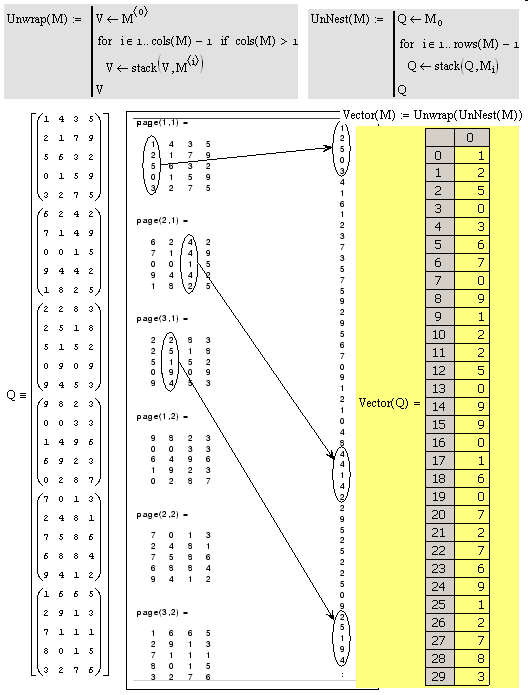

What Matlab does Smath does as well with lot more user specifics.
Matlab => MDA [Muliti Dimensional Array]
Mathematica => Cell Array
They just have their system. I can do whatever from this example
and very quick too, just few more modules.
