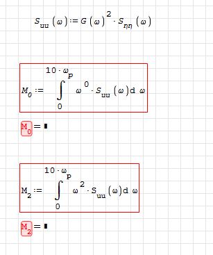

Hi All,
I am doing an integration of a range. Unfortunately I cann find the solution. Can't see where is the problem.
Any advice is appreciated.

Hi. You can't integrate functions defined in a "complicate" way, this is: can't integrate functions with "if", other constructors and ... solve nor roots.
The workaround it's implement your own numerical integration procedure, or use a odesolver for get the numeric integral.

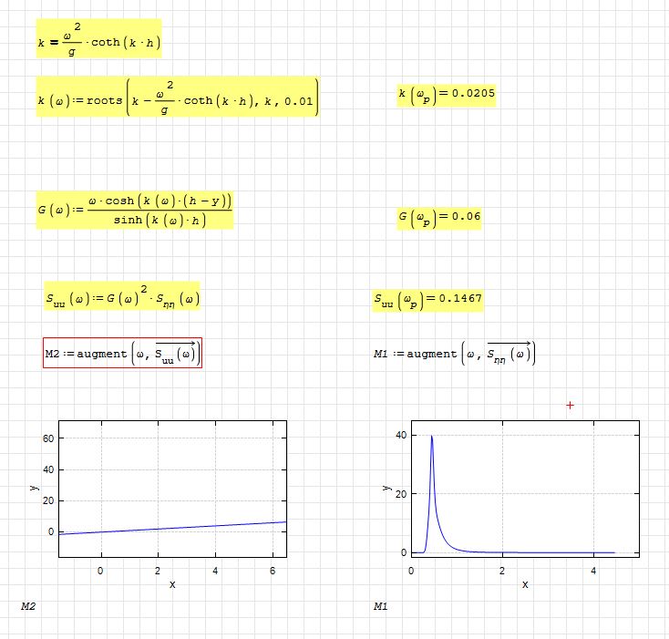

Hi Razonar & Jean,
Thanks for the advice. I still cant find a way to rewrite the equations given there is k in both side of the equation to solve.
Need to solve the k in the function of w to continue calculation. Any suggestions is welcome.

#7 Posted: 1/22/2021 10:40:09 AM
Hi Jean,
I don't see any document.
I don't understand much in your stuff !
As it looks we can integrate something in there.
Page4 (1).sm (27.79 KiB) downloaded 1357 time(s).
