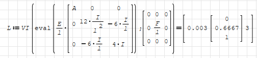

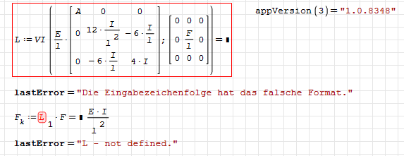

The attached sheet used to work and now doesn't.
The regression happened somewhere between build 7803 (works) and 7822 (doesn't work).
Also strange: the german error message even though the UI language was set to english.
Vektoriteration AEWP.sm (17.21 KiB) downloaded 1667 time(s).

Is this the correct result?

Yes, it is correct. Yet I consider the need to place eval() being a workaround for a bug. A similar workaround is to introduce an intermediate variable.

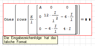

It seems that the error is related with broken logics of matrix operations. If I remove the factor in front of the matrix, then the function call works. Seems that at some point the evaluation logic thinks that the expression is not a matrix and complains in a not very helpful way.
Actually I found the culprit, it's the Ones() function. Davide, if you could ask that function to evaluate it's argument before refusing it, that would be fine.
