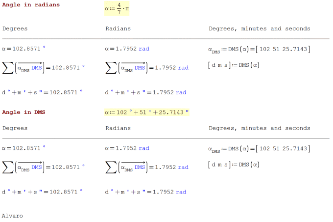

Hi. Here, my workaround.
DMS.sm (17.67 KiB) downloaded 1188 time(s).

Hi. Try this as general rule for SMath sintaxis:

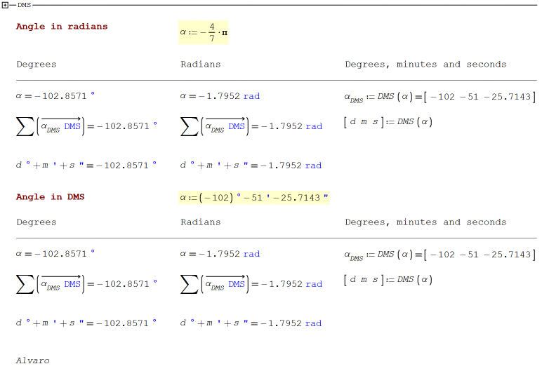

I think I will need to leave the negative angle input as [ -d -m -s ] with this approach. Would you agree?
Guess yes:
