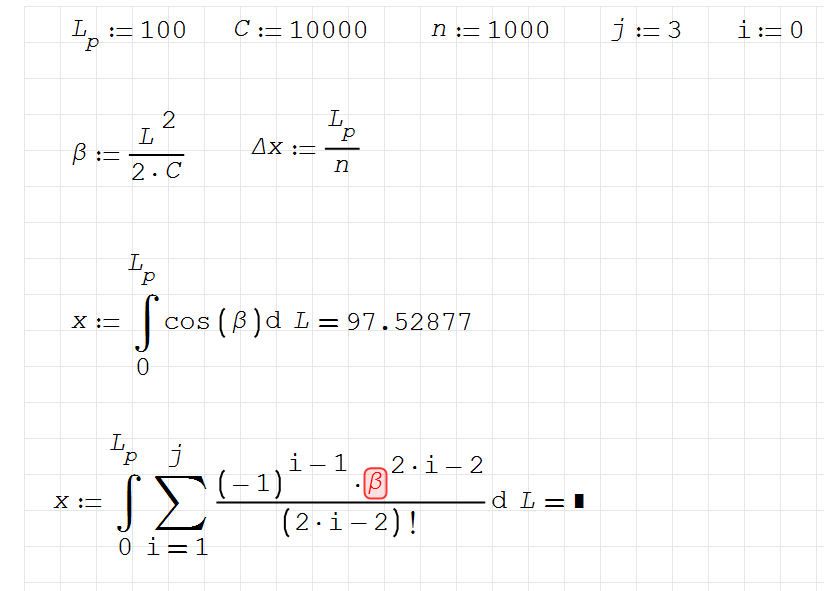

Why "beta" works in Cos(), while it doesn't in the second integration?

#2 Posted: 1/9/2021 10:36:56 AM
2,343 likes in 4,056 posts.
Seems it is an error in combination of int() and sum() functions. Will check this.

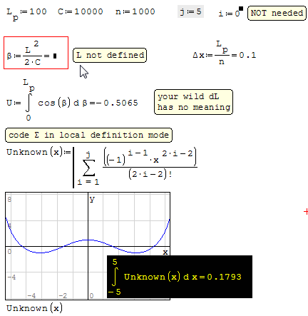

#3 Posted: 1/9/2021 11:27:36 AM
Maybe like this.

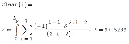

#4 Posted: 1/9/2021 11:53:57 AM
1,139 likes in 1,805 posts.
Hi. You define "i:0" at top right. Sum() index is not local and take that value. You must to clean i or use another letter.
